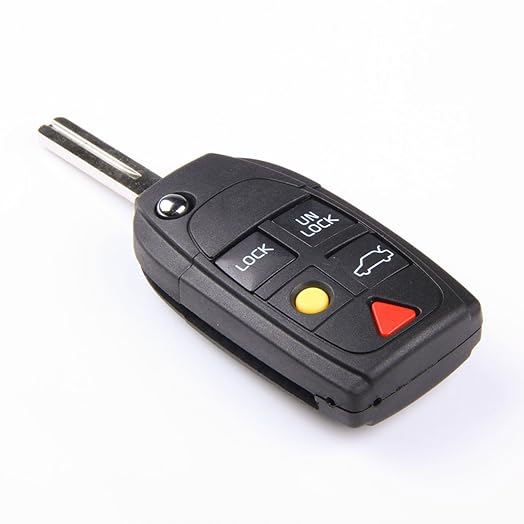

Bought a second hand ignition barrel from a breakers to go on teh V70, mechanic has fitted it. Car now imobilised ffs!
What are the options to get this sorted? surely the key that came with the new barrel needs to be coded to my car or the blade swapped into the old key fob?

take old key hold body of key right next to the new key and turn ignition.
the ECU generally holds the codes
the barrel either has an RF antenae built in or as a ring round it
the rf pip tag is in the key usually - these are coded to teh ECU.
if it works with your key next to the barrel key then open keys and swap over the pip tags.

Not a Volvo expert but essentially you are right the immobiliser chip that works will be the one in the old key but the blade from the new one fits the barrel... So some recoding/swapping will be needed I imagine

Need to swap old blade for new blade - next question HOW?

Wrap the replacement key in kitchen foil to block the radio and hold the original key near the new key while starting.
Hopefully will work. If so drive to main stealers to get new key coded [prepare to bend over].

Need to swap old blade for new blade – next question HOW?
My Ford key can 'break in half' when you change the batterry, allowing swap of electronics, and IIRC my old VW keys were the same.

Its around £300 to get a new key coded to the car. Volvo are pretty muuch the only manufacturer not to give out the codes to 3rd party key coders. The codes are generated and stored in Volvoland Sweden and thats that.
So yu need to split the transponder buton push par from the blade , and put the old electronics onto the new blade . Should woork fine after that. Its £90 for a blade cut to match the barrel from a main stealership . Diddly 3mm hex bolt iirc.

It’s not the blade that’s the issue per se - the transponder is in the wrong fob now

It’s not the blade that’s the issue per se – the transponder is in the wrong fob now
Can you not just swap the blade from the original key to the new one, following the guide to open it up that Captmorgan posted?

That's transponders are generally also easy to move from key a to key b..... Lightly glued in. I remove them with tweezers.
