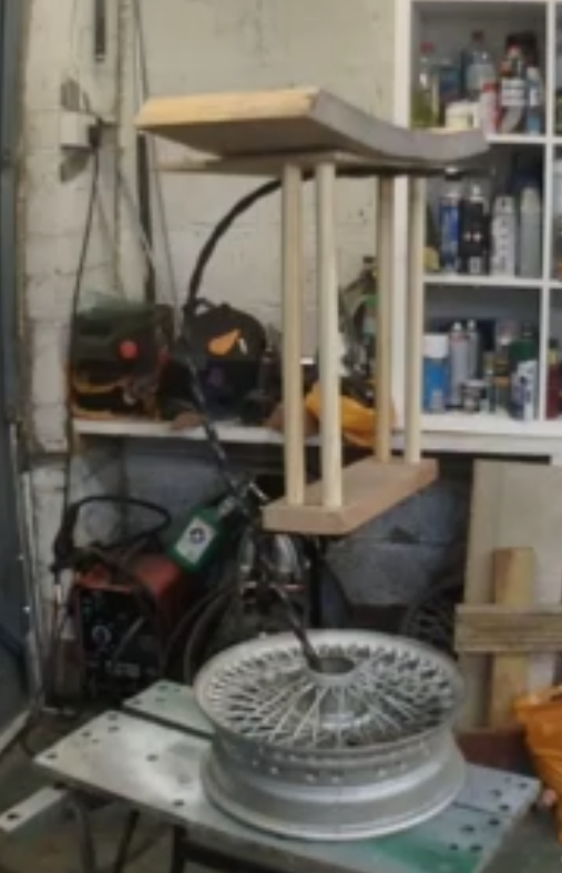

I was looking for some steel to make the base of my tensegrity chair and thought this bit looked pretty so I bought it.
It is approx 10mm solid square with the twisted spiral added. My first thoughts were to just cut straight lengths to act as legs and then weld them to the box steel to give me somewhere to mount the cable mounts.
Now I am thinking that it might look pretty if instead of two straight legs it just had one curved leg, a bit like a banana hook, welded to a strong heavy base.
and this leads to the questions.
1) How easy is it to bend cold rolled steel bar and does my home made steel former in the picture look suitable?
2) I guess adding heat (propane blow torch enough?) would help in the bending but is that likely to deform the metal / spiral effect or wreck the steels strength?
3) If I can bend it to the shape I want, what stops it carrying on bending?

Safety footwear.
Top work 🙂
Posted : 18/06/2020 4:40 pm
Posts: 13671
You can see the colour of the top of the right toe nail. That would have really hurt if it was stuck inside steel toe caps
Posted : 18/06/2020 4:42 pm

Yes, I have a bench vice - the clamp was just to show the concept. I did wonder about the blowtorch, as you say it is a fairly chunky chunk of metal.

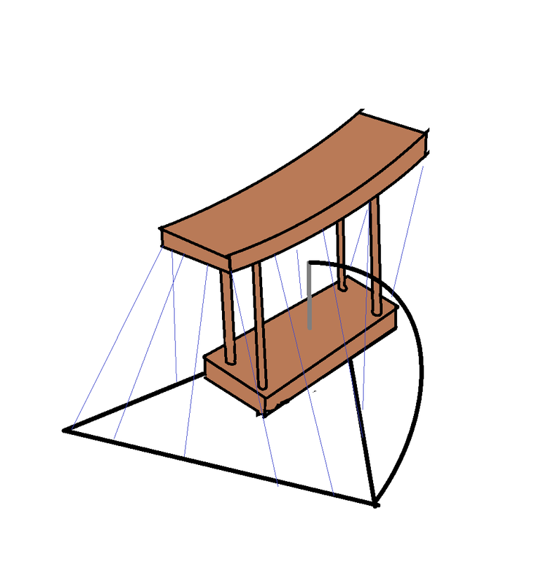

I disagree about distracting from the Tensegrity though. Instead of having two straight legs with a bar between them and the cable hung down there will just be a single arc of metal holding up the chair. Artistic differences 🙂
To the question of bending it though. Can I use the 8 feet of leverage plus scaffold pol on the end if I need more leverage to get it to curve around in a graceful arc?
Is it likely to continue to bend if I then sit 18 stone plus the chair on the end of the arc?
Posted : 18/06/2020 4:54 pm
Posts: 13671
It is hard to show 3D in MS Paint but sort of like this
Posted : 18/06/2020 5:09 pm

Off to the garage with a selection of clamps and levers
Posted : 18/06/2020 5:41 pm

Got to give it to the old fella, leverage is strong stuff. Turned out to be quite easy, in fact I am now a little concerned about the weight bearing capacity so might make up some decoration bracing that hopefully won't detract from the simplicity.
Finishthat - I was videoing it so that the medics could see which bits went where
First Loose fit
All that remains now is to work out the main strain cable, all of the support cables, fit the upper legs into the seat base, weld the lower support into place, add ornamental bracing, clean back, pain, oil or lacquer the wood, check that it actually works and then wait until next Thursday for the bin men to collect after MrsWCA has seen it and made her views clear, 🙂
