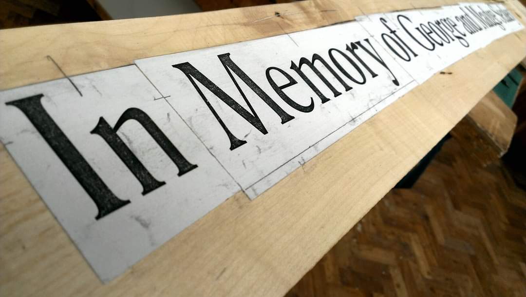

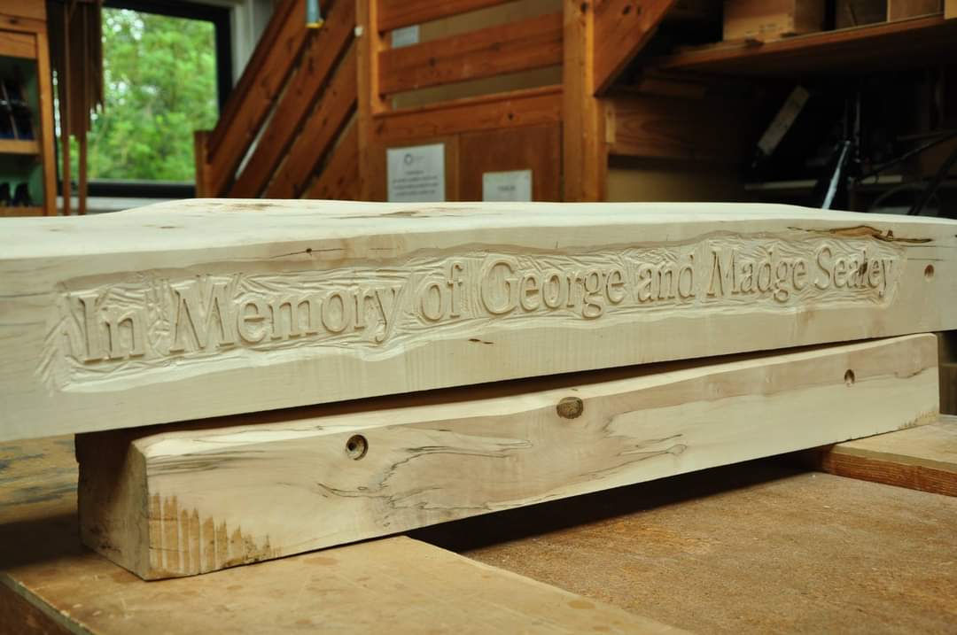

I used to make lettering by printing off the lettering, sticking it to the wood, routing near to the lines, crisping them up with a chisel, then cutting away more material around, so you end up with letters that are proud.

Posts: 18164
Did this one in the way I mentioned.
Posted : 20/08/2020 11:30 pm

Posts: 453
Kayak
I have to say I am super impressed and want to give it a go despite the fact that I have zero woodworking experience.
Do I need a plunge attachment?
Did you fully stick the letters on the wood?
Posted : 22/08/2020 10:59 pm
Posts: 18164
Kayak
You don't need a plunge router as such but you do need to be very mindful of hand position while doing it. It's easier with a plunge router but a Palm router is great for the smaller work.
You can get a very nice effect by just cutting a couple of mm or so deep.
With a Palm router you basically hold it two handed, tilt it over, start it up and carefully bring it back so the cutter plunges, then you're away. I tend to keep a vacuum going, tilt the router out of the cut, remove it and vac the chippings away now and again. You need to see the lines well.
I used pva to stick the printed letters on. You want them stuck on well as the paper has a tendency to fluff up and peel off otherwise.
You want to do the area around the letters first. If you cut away too much 'relief', bigger than the router base, then you lose support for the important bits.
Go nice and close to the letters, two handed, eye protection essential as you're quite close. Afterwards, crisp up the edges with a chisel. Curved gouge if you've got one for the curves, otherwise can get away with a small chisel.
All the gouges in mine you can see was purely to make it look a bit more hand carved. It was of course dead flat.

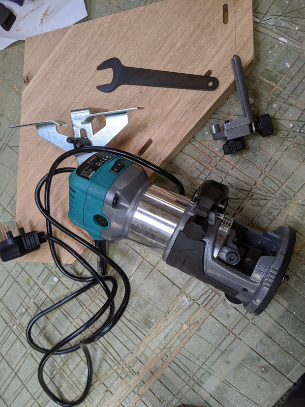

Posts: 18164
Just to say I ordered a Katsu Palm router and got it today.
Seems really well built actually. Very impressed. It was £33 off Aim tools on eBay.
Doesn't seem much difference in quality to my Makita but we'll see how we go. 😊🤙
Good for sign making.

Posts: 9258
I did find with my Makita trimmer, the base initially didn't appear to lined up with the cutter, being circular as you know it should cut evenly however its turned in use, and being a trimmer,thats kind of what you tend to do. I found the circular base overhung slightly at different points, and even the slight play int he mounting holes didnt ensure all of it was flush.
I would check the ebay model for the same fault. I used the sander to smooth excess,refitting till it was flush.
It was just a tiny bit overhanging, but....
