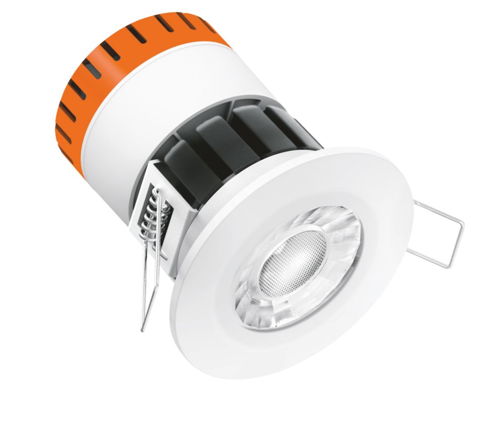

Assuming you want IP65 ratings for the bathroom?
Just fitted 25 of these 8W IP65 rated ones, integrated bulbs so get around the low energy lighting requirements for BC. Also integrated driver and push fit terminals. 60 deg beam puts the lighting pattern about a foot from the ceiling with a decent spread of light
[img] http://s7g3.scene7.com/is/image//ae235?src=ae235/5761J_P&$prodImageLarge$ [/img]
ENLite Fire Rated Fixed E8 LED Downlight IP65 Warm White 8W
Also available in cool with different bezels too, worked great for what I need
