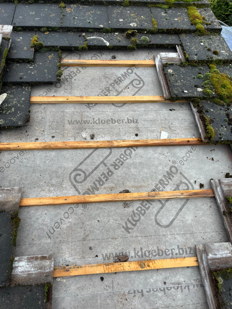

Posts: 7120
Posted : 10/02/2026 10:08 am
Posts: 6063
Yup, what you've got there is a roof. Good jahhhb! 👍 🤣ย
The slats definitely have some water soak, but many of them look OK. You could perhaps get away with replacing a small patch of affected tiles - until the next old tiles go.ย

Posts: 7120
The leak comes in from right at the top of the roof.
But these tiles are actually further down than that.
I wonder if there's a leak in that membrane at or near the ridge line.
Posted : 10/02/2026 11:39 am
Posts: 14273
Posted by: oldnpastit
Well yes.... water doesn't tend to go uphill so, as I mentioned before, it could well be a ridge tile issue.ย  That said the two lowest battens on the right look like they've been getting wet.
(Of course not all the water getting past the tiles is nec. getting through the membrane, so you could have a leak further up* and battens showing evidence of extended water exposure lower down).
I would have thought you need to uncover more higher up.
* Additionally, water getting past the membrane will not immediately show in the room below - it may run down the top of the plasterboard until it can find a joint/exit route.
Edit: Is the water blowing in from the verge [edge of the tile at the gable end] which should be fairly sealed.ย  Maybe possible if it only leaks in one wind direction.
Posted : 10/02/2026 11:49 am

Posts: 47
Yup, check the ridge. If it's a traditional system a small gap in the mortar could cause issues if the membrane has failed or doesn't overlap properly. Relatively cheap install for a dry ridge system rather than repair. There's a lot of moss between those tiles where water could build up and track underneath the tiles.
Posted : 10/02/2026 4:37 pm
Posts: 1475
Posted by: ley_line
That was my first thought on seeing the photo. I get up on our roof (built 1977 or so) with a yard brush every couple of years to try and sweep the worst of it off when it's dry.
Posted : 10/02/2026 4:44 pm
Posts: 3546
my first port of call would be removal of the moss which in my experience will prevent water running off smartly during rain and in some instances where it has grown under the tiles allowing water to wick in. Long term it will help to saturate the tiles and or substrate which then becomes more prone to frost damage.
when you clean off the moss you may find a damaged tile that was otherwise hidden. On my old house with similar pitch i would walk up with a stiff brush and scraper on a dry day and clear it off. After rain it would then dry very quickly whereas before it would be sodden for ages or even days with plenty of opportunity for water to leach about and under tiles. I also found a couple of tiles that had been botch repaired with mastic
In my experience most roofers will generally want to remove all tiles regardless of whether they are reusable, and then replace with new as its an easily quantifiable job - they rock up, erect scaff, strip off straight into a skip, new tiles arrive on site , they get handballed up and hung. Job done. So you may need to find a different sort of roofer who is happy to investigate and footle about
on my current house i knew the existing membrane on the front elevation was knackerd so we stripped off all the slate tiles, removed the membrane, repaired any rot or damage to the sarking, put a new breather membrane on then re slated with original slates. I probably lost 15 slates total during stripping. I'm not a roofer but we were able to strip and stack ready for putting back - it's not hard but is time consuming and a bit of a ball ache to redress slates which is why lots of roofers dont really want to do it
