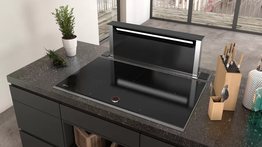

we had gas hobs and this extractor:
it's pointlessly expensive. The ex wanted it.
meh
