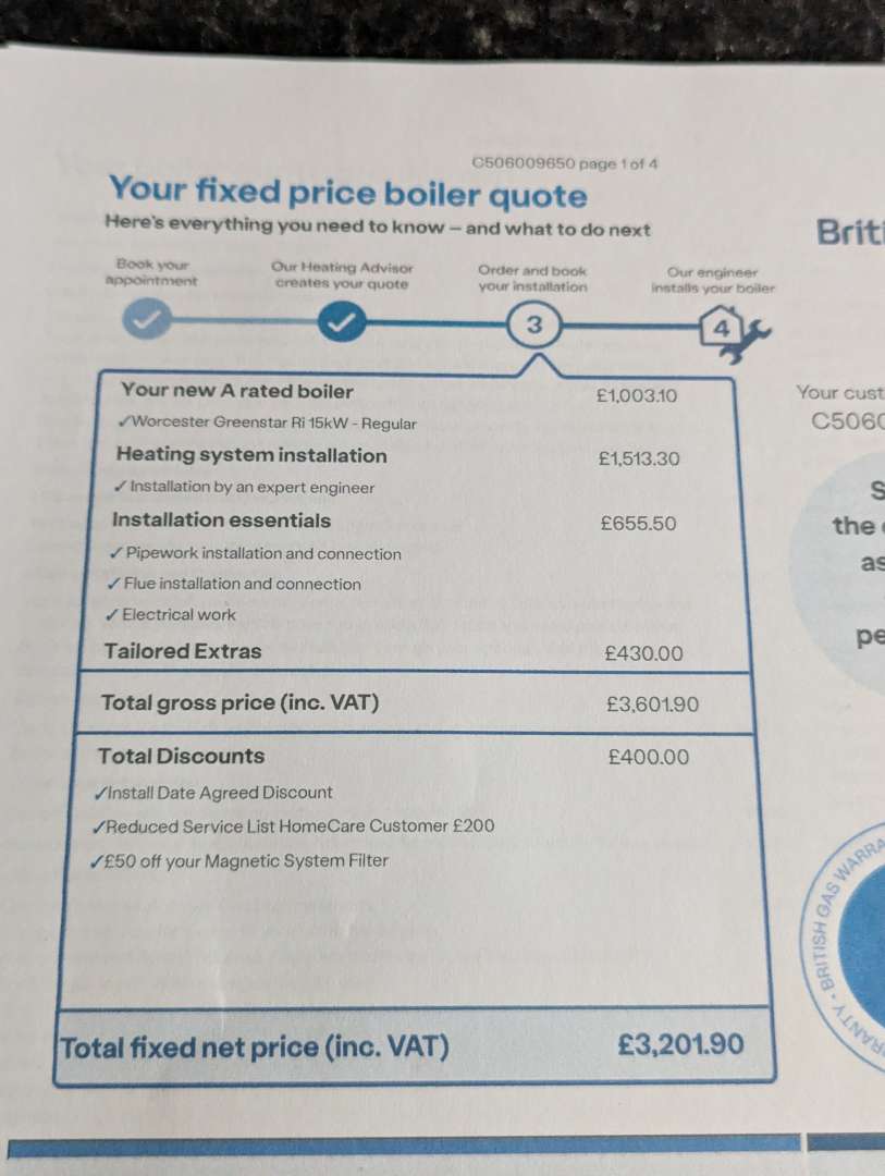

Because this quote is about double what I was expecting. Or is this just normal 2026 prices?
Our boiler is still functional but it's on its last legs and the thermostat is becoming sentient and trying to cook us in the middle of the night. We're not desperate but need one this year probably.
This is from British Gas. We already pay for their Homecare service which to be fair has been worth every penny during a couple of different failures.
I won't bored you with the details but we've had a nightmare in the past with man-in-van plumbers who come via word of mouth recommendations. Especially when you need one in an emergency. The British Gas engineers have been spot on in comparison.
Still, we don't owe them anything so if I can have the same kit supplied and fitted for less money it's worth asking.
Oh, and I just realised I have no idea what the 'tailored extras' are.

Looks pretty good to me. I wouldn’t have expected much change out of £4,000-£5,000 so it looks like a bargain.
I wouldn’t get another Worcester. Given the choice I’d go for a Vaillant or Wiessmann.

If you are comfortable with British Gas it's not that far out price-wise - especially if you don't already have a relationship with a decent local plumber.

Does that say a 15kW boiler? That's pretty small, I hope that's for a compact 2 bed house with no big loads like a shower. Yeah expensive. When I was considering replacement vs. a big repair bill earlier in the year the likes of Boxt were quoting about £2500 for a 25kW compact combi straight replacement with no complex relocation or system changes.
its not a combi - you only have an oversized boiler to meet your instantaneous hot water needs. If your using a system boiler it can be vastly smaller sized to only your heat needs + a little.

It's not a combi. We have a pressurised system with a big tank upstairs. This includes a magnetic inline filter and Hive thermostat.

It’s not unreasonable surprisingly for BG, but BG do tend to be much more expensive than independents

The fitting charge sounds a lot if it's a simple swap out... If your relocating the boiler or the pipework is a mess it sounds OK.
The boiler almost sounds too cheap though so...
As pointed out to me when commenting on the size, it's not a combi, so cheaper.
Make the full quote look even more pricey!
