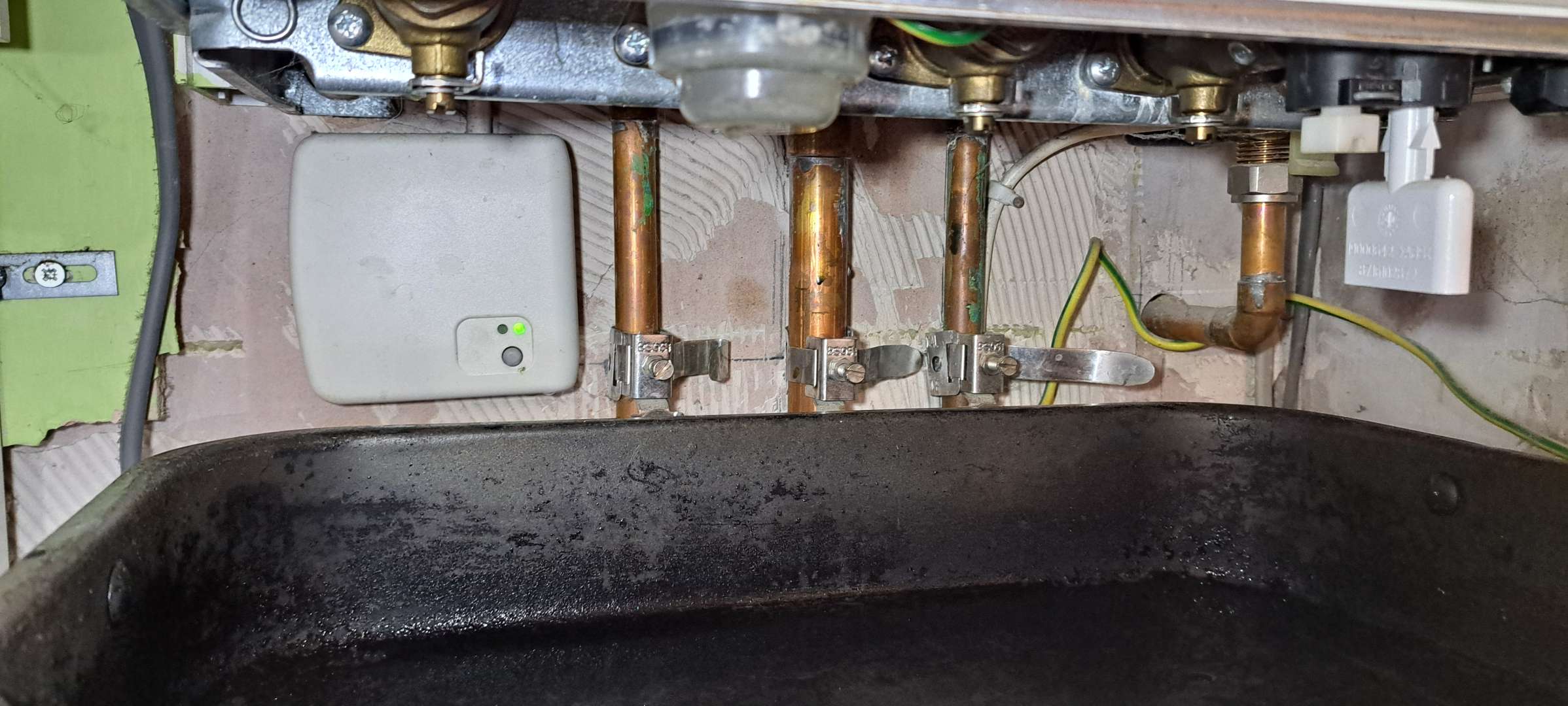

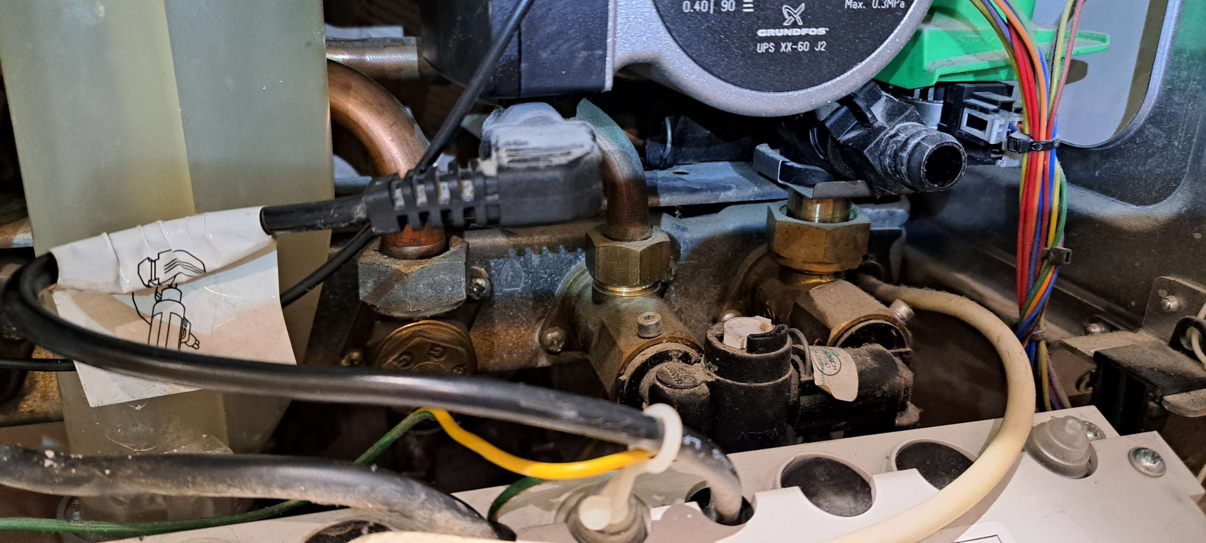

Turns out the man hasn't fixed the leak. We are going away so I need to turn the water off.
Will I need to turn the power off as well?ย
It's a Worcester Bosch Green star 28 junior.
  1. Apparently there's an isolator but I don't know what it looks like. 20260129_185837.jpg20260129_185808.jpgย

The isolator is going to be on the other end of that white flex snaking downย  to the right of the three pipes.
Will (should) be like a light switch with a second bit for a fuse. And possibly a neon light.

The only thing you need to do is switch off the boiler. As above use the fused spur or even just the power button on the boiler. I don't mean to be rude but messing about with the gas tap is not for someone who doesn't know how to switch off a boiler, and it really isn't necessary.
If you want to isolate the water then just pull that white plastic key thing out of the black plastic contraption, bottom right underneath the boiler.
