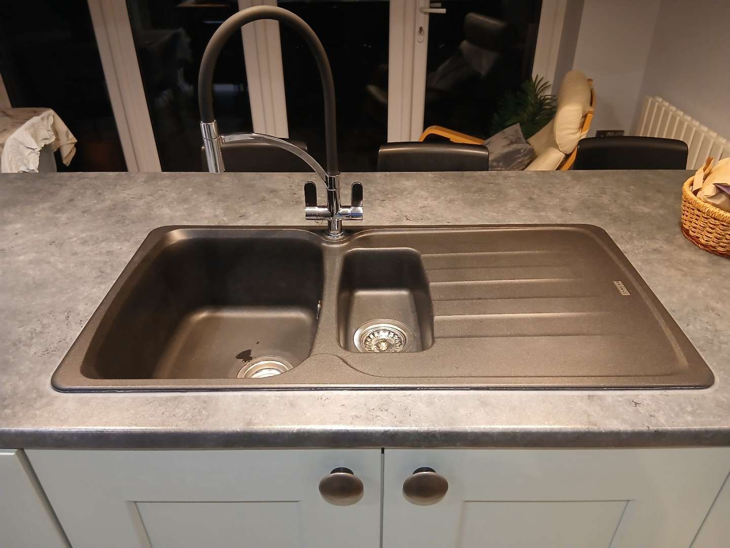

I've granite worktops in my kitchen, which has been in for about 12 years now.  The sink (stainless not that it matters) is looking tired and id quite like to change the sink for a new one.  Now sinks are all slightly different sizes,  needing different cut outs.  I'll hunt for one exactly the same as the current sink but, if i have to go fractionally bigger, how do I cut the granite worktop?
Competent diyer,  I fitted the kitchen,  but I got the worktops cut and installed for me.  Closest ive done is cutting large tiles on a table top tile cutter with diamond wheel.
Worktop id cut in situ.  I guess a diamond wheel in a handheld mini circular saw, lots of water (that'll be fun, not), slow cuts taking a mm or 2 each time. Or is there something better?
Huge scope for a costly error.....I may stick with the current sink no matter how tired and manky its getting!

Who does custom sinks?  Is that a thing?
Posted : 14/01/2026 8:53 pm
Posts: 5792
Prize if someone can find a 500x965mm 1.5 bowl and drainer.  Ideally id fancy a black resin composite but well...beggars can't be choosers.
Posted : 14/01/2026 8:59 pm
Posts: 5792
I've just realised a good deed by my then gf, now wife's,  dad has made this awkward.
When fitting my kitchen I was also fitting my then gfs. Her dad worked as a joiner in a factory making static caravans and got her a couple of bits cheap.... her laminate worktop,  a sink and tap. I commented the engine turn like finish on the sink was nice.   A week later I got presented/gifted an identical sink.   It wasn't actually what I wanted but it was nice,  and a gift so...I stuck with it.
Now im guessing it was slightly smaller than 'standard '  as it went in the vans.   I never knew..  oh dear!
Funnily the engine turn finish is what I now hate as it makes the sink filthy all the time
Posted : 14/01/2026 9:26 pm

Posted by: neilnevill
Franke sinks might oblige you here. We've got one that's very close to those dimensions (970 × 500) and still looks fine after 2 years. It replaced one that was about 12/13 years old and had started to get a bit tatty, with a couple of chips in the top and had tea stains round the plughole.

Posts: 5792
Thanks lawman, yeah I've found a Franke June's tectonite 1.5 bowl that is 500x970.  If I'm really really lucky it might fit  or at least and sliver of granite remove must be better than 35mm
Or a s****y looking glass topped thing with zero fall to the drainer so it doesn't matter how long the cut out is as its all above the worktop... and yes if you read the reviews that is the bad idea it sounds like! 😆
https://www.plumbworld.co.uk/sauber-15-bowl-kitchen-sink-with-black-glass-drainer-19482-33217
