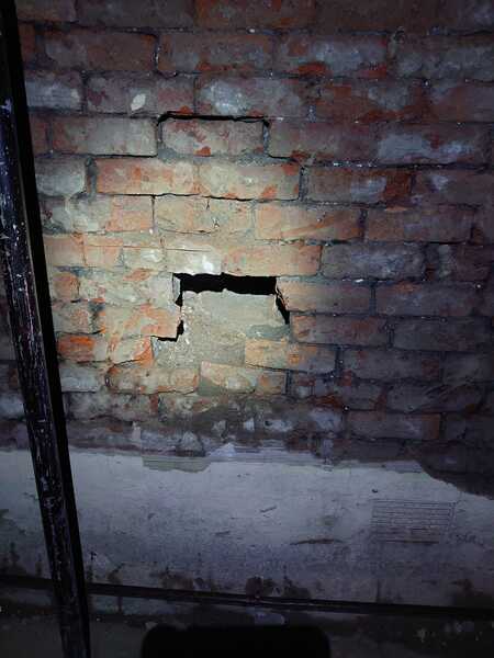

 DSC_0007.JPG OK folks, place your bets!
Loads more of the old render was stripped off today. It was scarily easy to do and has now revealed a disintegrating chimney with the void filled with old bricks and crap from when the chimney was decommissioned years ago. The rubble Nd mess has bridged the gap and is sodden. I could pretty much squeeze moisture out. The internal wall that aligns with this was tanked last year by the same builders we have in now. They told us that it was a two year stopgap.
So- how much to rebuild a 1 x 1.5m external wall? Lintel will be required!
I haven't discussed it yet with the builders but I reckon about another £600.00
