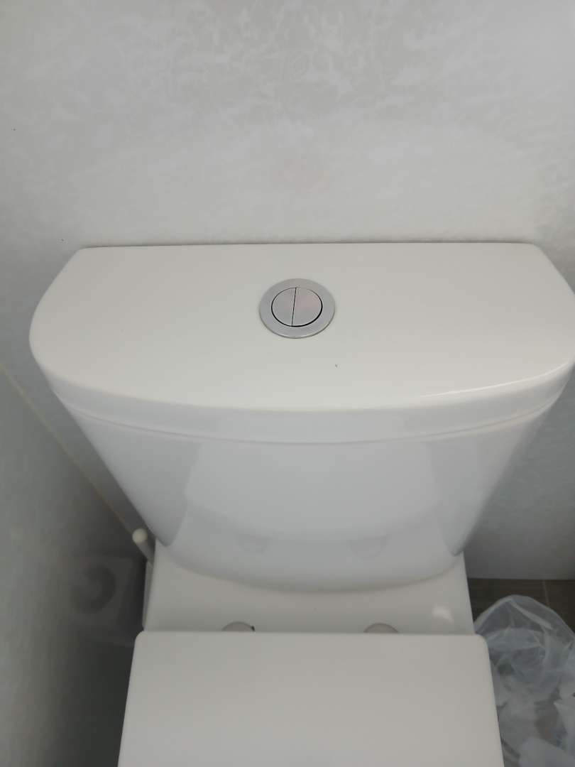

I've just looked at the two toilets here.ย  They both have the same two-button flush (branded K-VIT) but rather than an outer button with a tiny inset one (where the inner button is clearly only meant to be pressed along with the outer) it's more like a crescent moon and an almond so it's less obvious as to which is which.ย  Similar to the pic below, only in a less gopping finish:
Both pairs of buttons appear to operate the same design of flushing mechanism. The two halves each have a rod which pushes down one of two plungers on top of the syphon (very similar to @thelawman's photo above).ย  The white plunger is as close as makes no odds a full flush, whereas pressing the blue one there's an audible 'thunk' when the water level drops to about 3/4 so I'm guessing there's some sort of (adjustable?) stopper valve within the blue side.
Here's where it gets curious. The mechanisms in the two bogs are mounted at 90' from each other.ย  Ie, one cistern has front & back buttons and the other left & right buttons.ย  Whether this was due to some plumbing / physical space restriction or simply how they happened to get installed I have no way of knowing.ย  But whatever the reason, they are functionally opposite.ย  On one bog the blue plunger is plunged by the almond button, on the other it's plunged by the moon button.ย  So whichever way round it should operate, one of them is wrong.
