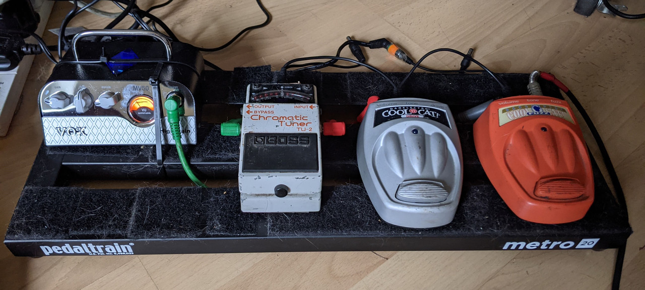

The mini Vox amp worked really well with my boost, drive and fuzz pedals. A pleasant surprise!

Excellent. That's one of the few things the THRii doesn't do well. Light overdrive is ok, anything more is just wrong.

Been working on my mini-rig:
It's almost everything I need, and is easy to carry. Band practice on Monday evening so will see how it handles it.
I normally use a TC Nova system for all the modulation/delay FX loop style effects.
However, have got a £17 Behringer analogue delay pedal getting delivered today which I'll put on the board. Turns out delay is pretty much the only time based/modulation effect I use a lot.
