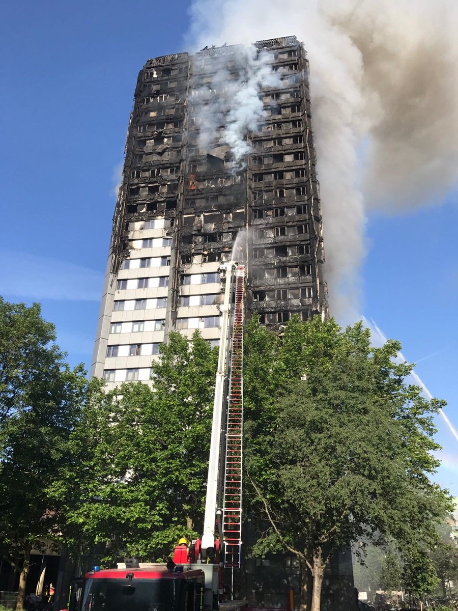

The investigation will almost certainly confirm that there were multiple failures in the building's fire safety: in general no single point of failure, such as chocking a fire resisting door open, should result in such a catastrophic incident.
The fire safety concept of flats like this is to build them as substantial fire resisting structures in which each flat is a fire resisting compartment and fire resisting doors in corridors will delay any fire spread. That should mean that a fire will never grow to the stage that the Brigade cannot enter the building and extinguish it.
Cladding can be an issue, either because it's combutible or because it can be installed with an air gap between the external wall and the inner face of the building and consequently act as a flue causing any fire that breaks out of windows on one floor to spread very rapidly up the side of the building and into through the windows into flats on the other floors.
However looking at the photographs it does not look like a cladding fire to me. I suspect that the issue is simply that once the fire is well developed and has engulfed a large area of a floor, and breaks out through the windows of that floor, the external heat and flames are readily able to break into the floors above one by one. The external elements of structure are generally not required to be fire resisting, so the ordinary glass and window frames (UPVC?) will not provide much delay to an external fire spreading into a flat.
It's not clear if the fire spread internally between floors to begin with, and I expect a major part of the investigation will be whether the internal compartmentation was comprehensively flawed, e.g. due to penetrations made in the walls and floors by contractors not being properly firestopped or the installation of doors etc. which were not fire rated. Even assuming the fire integrity was perfect when it was built in 1974, a building of that age will have had a lot of work done to it over the years, giving plenty of opportunities for mistakes to be made which could compromise its fire safety.

fire may well have started within a flat (compartment) however the speed and burn pattern would suggest the cladding was a major factor in the rapid spread.
I'm just going on the photographs, but looking at some of those again I could well be wrong, and the page wwaswas linked to mentions rain screen cladding (the type I described which can create a flue):
Externally, rain screen cladding, curtain wall façade and replacement windows were fitted, improving thermal insulation and modernising the exterior of the building.
It is possible to specify fire resisting cladding, but fire resisting does not necessarily mean non-combustible: if it's made of plastic, a fire resisting material will burn when it's heated in a major blaze like this one, so yes possibly a major contributory factor to accelerating fire spread between floors, once the fire was well developed and broke out through the windows on the floor of origin.

There was a gent on LBC this morning who stated the polystyrene used in the cladding was created with an oil based liquid which is a known accelerant, similar to the ones used in the huge Dubai fire a few months ago.
Posted : 14/06/2017 10:13 am
Posts: 924
I've been googling a bit more.
It looks like the external cladding was insulated, in which case the insulation material was most likely expanded plastic foam.
Moreover, if the fire alarm was defective, then not only did residents not get a warning, it may also have meant that the smoke extraction system and fire dampers which were supposed to be activated by the fire alarm did not work. These are supposed to stop the central stairwell and lobbies becoming smoke logged. [url= http://webcache.googleusercontent.com/search?q=cache:ym6NjHxAJyYJ:wittukgroup.co.uk/grenfell-tower-london-w11-1tq-regeneration-project/+&cd=7&hl=en&ct=clnk&gl=uk ]This is a link to the cache of a webpage of the Witt Group which describes the system installed at Grenfell House[/url].
There is a photograph of what are described as cladding panels being installed on the last page of [url= http://www.kctmo.org.uk/files/105552_kctmo_rydon_grenfell_tower_newsletter_may_2015.pdf ]this newsletter issued by KCTMO [/url]. The photograph is not very good, but they look like foil faced insulation boards, e.g. Kingspan Siteline, Celotex or similar, which is likely to be expanded polyisocyanurate (PIR) foam. It's not polystyrene, although it's conceivably possible that polystyrene could have been used elsewhere on the refurbishment, e.g. in a Sto Render type external finishing system with a render over insulation.
The oil based liquid being an accelerant sounds like garbage. Flammable gases like pentane are used as the blowing agent in the manufacture of plastic foams like polystyrene and polyisocyanurate, but it's the combustible nature of the plastic itself in a cellular foam with loads of air in the foam to provide the oxygen that a fire needs, that is the fire hazard of expanded plastic foams. Polystyrene is the worst because of the way it behaves in a fire.

This is Grenfell tower as I remember it:
Typical brutalist concrete construction for the period. there was only one stairwell in the building.
And this is what it looked like after the cladding had been put on:

There is a photograph of what are described as cladding panels being installed on the last page of this newsletter issued by KCTMO . The photograph is not very good, but they look like foil faced insulation boards, e.g. Kingspan Siteline, Celotex or similar, which is likely to be expanded polyisocyanurate (PIR) foam
This is the same cladding system as I've just watched being fitted to an office e block I regularly visit in Glasgow. Basically a metallic channel system is bolted/screwed to the wall and slabs of foil faced PIR material are slotted inside. The whole lot is then covered with a rain/weather cladding, which I think is a Plastic/polimer material.
These materials will all have a class '0' fire rating, which is about as good as it gets, however this doesn't mean they won't burn, it just means they combust in a slow/controlled way.
That situation/environment looks like perfect conditions for those materials to combust - warm/dry/slight breeze.
However, it is still much more combustible than bare concrete...
Part of my job is specifying insulation materials for use on Naval platforms - modern PIR materials are about as good as it gets.

 chip
It was covered with acm cassettes which I think is made by kingspan.
Posted : 14/06/2017 11:43 am

Looking at this photo from the Brigade's twitter account, the two charred 'fingers' which were the lowest point of the fire on the left hand side indicate that the air gap between the outer metal face of the cladding and the insulation behind did act as a flue, especially where those vertical sections of cladding were continuous and not interrupted by windows.
The problem is that the class 0 rating is based on a small controlled test scenario, where a small flame is applied to the surface of a material for a relatively short period to see if the flame will spread on the surface of the material.
PIR and other materials with fire retardants added may pass this test because they will resist ignition for some time, and under such controlled conditions they may only char rather than spreading fire. However, when heated to several hundred degrees in a fire, especially one where the design of the building creates a flue drawing hot air and gases, they will very soon burn as intensely and fiercely as plastics without fire retardants.
EDIT The Class 0/BS476 test is by no means as good as it gets. For a while several years ago Kingspan and Celotex did submit some of their foil faced PIR boards for a more demanding test, LPS 1181, which is designed to better reflect real large scale fire conditions (although the ventilated flue in this application probably exceeded those test conditions and I am not aware that the current range of panels would fail the LPS1181 test, as far as I am aware the makers no longer bother to submit that type of panel for testing because there is no longer any commercial imperative for them to do so).
