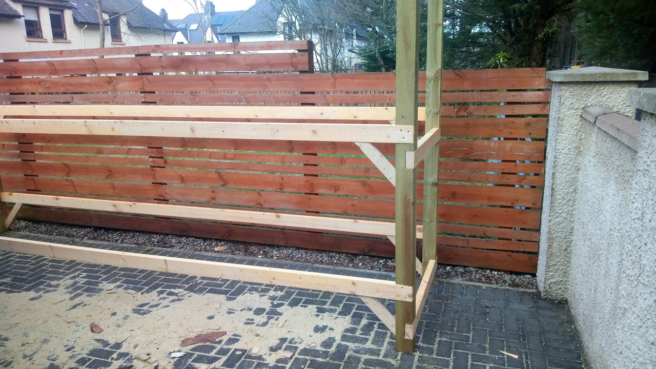

I'm making a canoe rack. my original plan was to put a sloping onduline roof on it, but I'm now wondering if I could put a flatter green roof on it. The uprights are 100mm fence posts and the rails are 100x47mm C16. the long span is 4.8m and i'd like the roof to overhang a bit at each end as the sea kayak is 5.2m
rack
Is it going to be feasible?

How do i account for the weight over a 4.8m span, cant have a centre support as I want the boats to come out of the side. And drainage, hadn't even considered that!
Anyone recommend a source of information?

As far as weight goes, sedums will grow on a light scattering of dirt on a bit of old carpet. You would probably need some additional strength in the structure, looking at your pic, but as long as the depth of material is small, and there is a way to help it drain easily (think about the pitch of your roof), you should be OK, it's a small area.
Presumably you're putting a slatted structure to support the kayaks? Make that beefy, maybe some extra thickness in the top of the frame, a vertical brace at the back and diagonal at the front?

I thought the span would be the fly in the ointment!
I need it to hold a canadian, a sea kayak and 2 river boats so bracing would really get in the way. I suppose my choice is between ideal storage and ideal roof 🙁

The span is fine, you just need to size the timbers appropriately. Probably somewhere around 200mm, but you can go a bit undersized as it's not that critical.

How are planning on anchoring that bad boy down when its top heavy and loaded with voluminous lightweight objects that will catch the wind. Its a bit narrow to stay upright i reckon.
Posted : 27/02/2021 4:17 pm
Posts: 4747
Bloody hell, I thought gravity would do that, it weighs a fair bit even without the roof.
I could tie it to the fence posts I spose?
It'll be open all round so the wind will mostly go straight through?

I suspect a green roof would counter any wind uplift, dead weight will be circa 2kN/m2 against an uplift force of say 1.5 at worst.
Sizing the timbers will be important and installing a slope. If it's flat and the timbers sag and it rains you might end up with a problem.
Typical build up would be ply deck, waterproof membrane, drainage layer about 25mm thick, growing medium say 40mm thick then a sedum mat.
Slope across the shortest distance and butt the above against a perforated angle. Either let it run off the the rear or use river cobbles in a drainage channel.

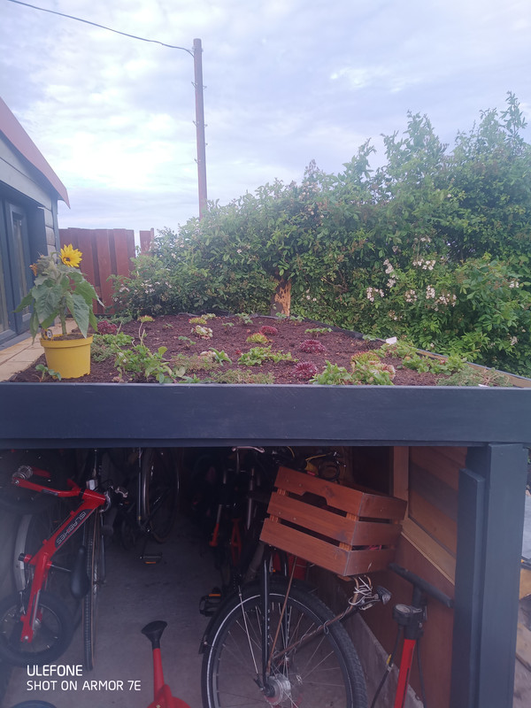

Well I have finally got round to building mine.
Its pretty much flat 6 ft across and 8 ft long.

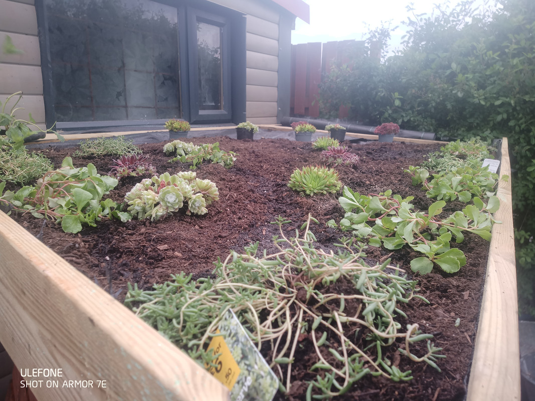

The bed is 4 inches deep I've gone for an unconventional method of using what was lying about so
It's 4*2 timbers with a ply deck with visqueen dpc plastic -then some 12mm rebar mesh I had lying about with fibreglass roof reinforcing mesh with minimal gravel -then weed suppressant. Then about 25mm compost/soil mix and sedums /mint /thyme /dill/corriander/basil
More importantly my cargo bike now has a dry home in an easy to get to location.
Posted : 15/06/2021 5:34 pm

Waiting on more compost Nd have changed my mind a bit. Due to the window height and the height of the child seat on the cargo bike the roof is considerably closer to the window than I'd have liked. So gonna move some of the flatter sedums from the front to the rear where the soil is going to be much thinner and then build up a bit at the front and try from some strawberry's growing over - not too hopeful as it's still a bit thin 4-6 inches soil recommended. I'll probably have 2 inch tops.
Lotta bare looking space here but much of that is seeded with herbs.
Posted : 16/06/2021 9:42 am
Posts: 39700
Filled it up , got my strawbs I'm and they are growing well (were bare root no leaf when I got em) the mints going wild and the seeds are sprouting in various place
Dicht o paint and a tidy up inside.
I'll wait the whole thing falling down since I ignored the trada span tables to a point as I'd not have got the bike in with a roof 6 inch timber based roof between the window and the ground ....and I'd rather put the shed up ever 5 years than have a shed not fit for purpose.- that said the roof timbers almost doubled up rather than 400 centres.
