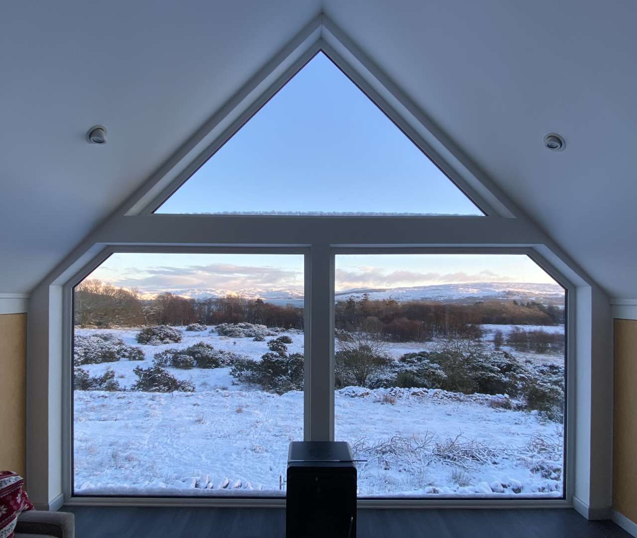

It’s 4.5 years since we moved into our self-build and I suppose lulled into the thought that the succession of jobs needing done on a new house would somehow cease..
This week I’m still putting right some of the things that weren’t right, like the recessed spotlights in the angled ceiling where they’d cut through the vapour barrier and into the foam insulation to install recessed spotlights. You could feel a breeze coming through the lights and we were getting weird condensation on the windows. I’ve had to patch the vapour barrier and install slimline flush spots.
The architects in their wisdom put the front door on the ‘weather’ side - with the winter storms, water gets blown under the door which has been absorbed and blown the skirting. Talking with the door company about replacement seals.

Posted by: dovebiker
Where's the blame for that? Specification was clearly wrong - who selected flush lights where there wasn't space behind to allow for them? But also crap workmanship because if the electrician cared about the build they should have identified the issue at first fix, or even when they came to cut the first hole in the plasterboard, and made clear that either surface mount or slimline spots were needed.
We've had very little in 10 years in ours but we did almost all the work ourselves so did both the spec and install. I had a Chinese DMX 240v dimmer thing that blew bulbs.  Outside lights have been problematic - water getting into fittings and failing.  What we thought was a roof leak was actually a very minor lead from the kitchen tap tail that evaporated without causing any real issue unless we went away for some weeks in winter with the heating off.  We did have a condensation issue with our ventilation system but improved the insulation on the pipes and solved that. Haven't, yet, had any major jobs.  The first is probably going to be some external render in a lightwell where we didn't get the detail above good enough and water gets behind it.

Posts: 6922
Yes, the lights were fitted before we moved in, during COVID and just assumed they were installed correctly - they’re quite high up in a portal roof and need a ladder to reach them. It was only when I put my hand over one and felt a draught that I took a closer look.
