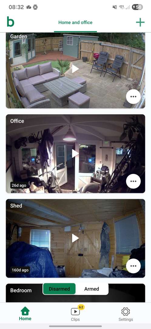

I have a few Blink cameras dotted about. Most are battery operated, but have a mains one plugged into the shed - you get the option of an led light on the mains one.
Wifi is via a power line adaptor plugged into the garden office sockets.
Notifications aren't loud though and I only generally see any movements the next morning.
