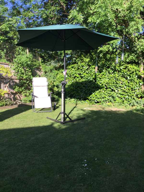

Just got one of those large parasols with the pole at the side. The base is quite large and I'd like to put it further into the corner of the patio. The pole is secured into the base by four bolts.
Options:
1. Find some kind of ground anchor with four bolts on top
2. Dig hole, fill with concrete, drill holes into concrete and bolt the base to the concrete.
3. ...?
Ideas?
