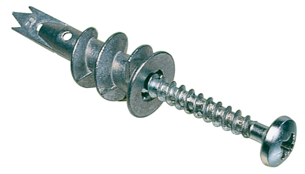

The central bracket of three needs to be mounted to a double layer of plaster board (which has also been plastered).
I appreciate this a terrible substrate to share the load of a reasonably heavy pair of curtains. However, this and the interior decor are beyond my control.
In terms of fixings, I've considered the following, which is probably the best idea:
[img] https://s7g3.scene7.com/is/image/ae235/11923_P?$autoprodblock$ [/img]
Or, these. The logic being that the expanding section will dig in between the two layers of plaster board and hold:
I could just use the biggest standard wall plug which will fit? Something like a 10 x 50 mm plug is probably the biggest I could fit with a screw diameter small enough for the bracket.
Any other ideas?
Cheers,
Paul

I used the things in the first picture, I can't remember what they're called. They work fine but remember to drill a pilot hole or it won't go in straight.

As above I used the top fixings for all of my curtains, they are all still there.

I've used the first things for basically everything in our house that's mounted on plasterboard. Curtain rails, mirrors, large pictures, shelves, television. Nowt's fallen down.

I've mounted radiators with the top ones. If they can handle a radiator full of water then I'm sure they can deal with curtains.
For that to happen, there would need to be quite a large gap between the two sheets of plasterboard. If there is an insufficient gap such that a good part of the expanding section of the bolt is inside the hole drilled in the inner sheet of plasterboard, then I suspect it may not work (the plasterboard around the expanding section will prevent it expanding properly).

Indeed, and I'm not sure you'd really know until it failed, as it would presumably expand into the outer layer of plasterboard. I'd be wary unless you knew the composition of the wall and were confident there was a significant void behind the outer layer.

hooli +1 as long as there's a decent gap behind the plasterboard.
Same issue in our new build - the big helical fixings (top of the OP) are OK but I've had two pull out so far.
Used the butterfly fixings in the garage (which for some weird reason was boarded throughout) to hold up bike hooks and they're still going strong three years on.

As everyone above - the first of your two options. At our house the previous owners had a secondary handrail fitted to the stairs (an old couple) and it was fixed all the way with those - my little girls could hang off it without it budging an inch.

+1 for the spirals but drill a very small diameter hole first to make sure you are hitting a cavity - otherwise they will chew up a big chunk of plasterboard when they hit a stud or frame.

Also, there's numerous different densities of plaster board. Most common is wallboard which doesnt have great pull out characteristics. If you have a high density board (often uses in social housing and public buildings) you'll get a better fixing.
Options in order of preference:
1. Fix to solid substrate
2. Fix a curtain batten to spread the load
3. Use plaster board heavy duty fixings
Posted : 24/10/2017 5:17 pm

The trouble with using the two types of fixing above is that they work loose with movement, ie. pulling curtains to open/close. They are fine strength wise for things like radiators or a tv but no way would I use them on a curtain rail unless it was to fix a piece of wood to then fix the curtain rail to.

These work well but...
...you want a setting tool for them.
I did a whole shoe shop of shelving with them and they've been fine, but as said above, they may work loose with time due to moving curtainage..
I'd consider the baton idea someone mentioned above to spread the loads.
