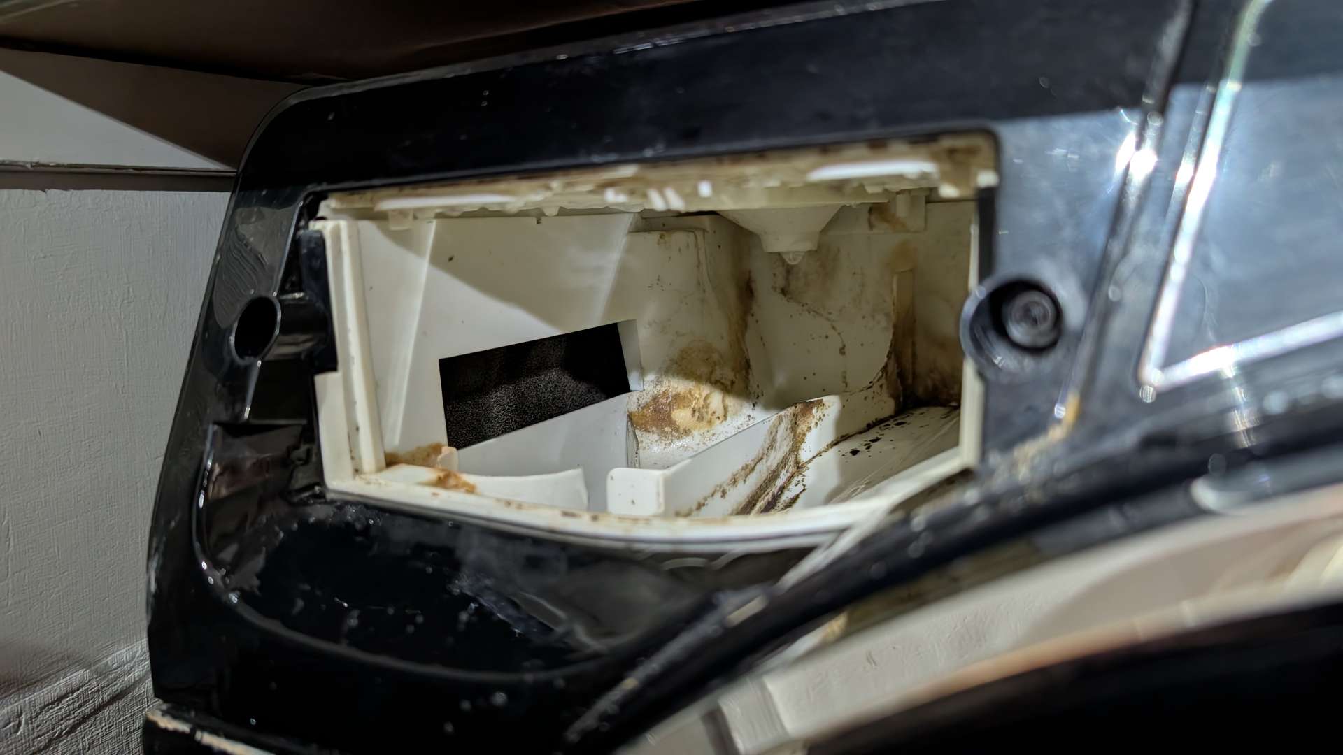

Posts: 3518
This shows the hole in the side of the tray I mentionedย

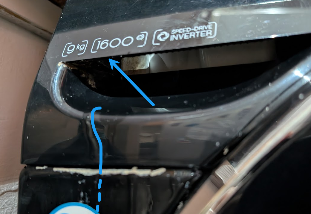

The plot thickens.
Mrs V set off the machine on a delicates wash earlier (stinky, muddy bike gear #tmi), and I sat and watched it (should this be in the "you know you're getting old" thread?).
Almost straight away I could see a trickle of water from the drawer, but weirdly it seemed to drip out of the handle (arrow) then trickle down the face of the drawer (line).
Since taking the pic I've managed to shift that lime-scale under the drawer ๐Ÿ™‚
Link to Video of dripping water, for added excitement: https://photos.app.goo.gl/utvsmt853AhJwsw66

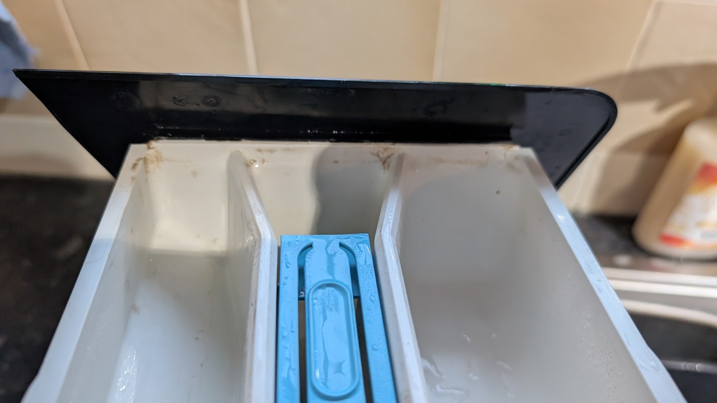

This next pic shows the inside of the drawer, I can only assume the tray is filling up and then the water is working its way through where the black and white plastic meet.
I waited for the rinse-cycle and removed the drawer, water seems to come into the tray area without any issue, and it seemed to drain away in to the cylinder quickly too.ย  I had assumed it would be slow to drain away, causing it to back up, but that doesn't seem to happen - well, not when the drawer is out, at least.
I still plan to get the lid off and check for a blocked breather pipe, as suggested above.ย  But currently I'm no clearer about what's going wrong...
