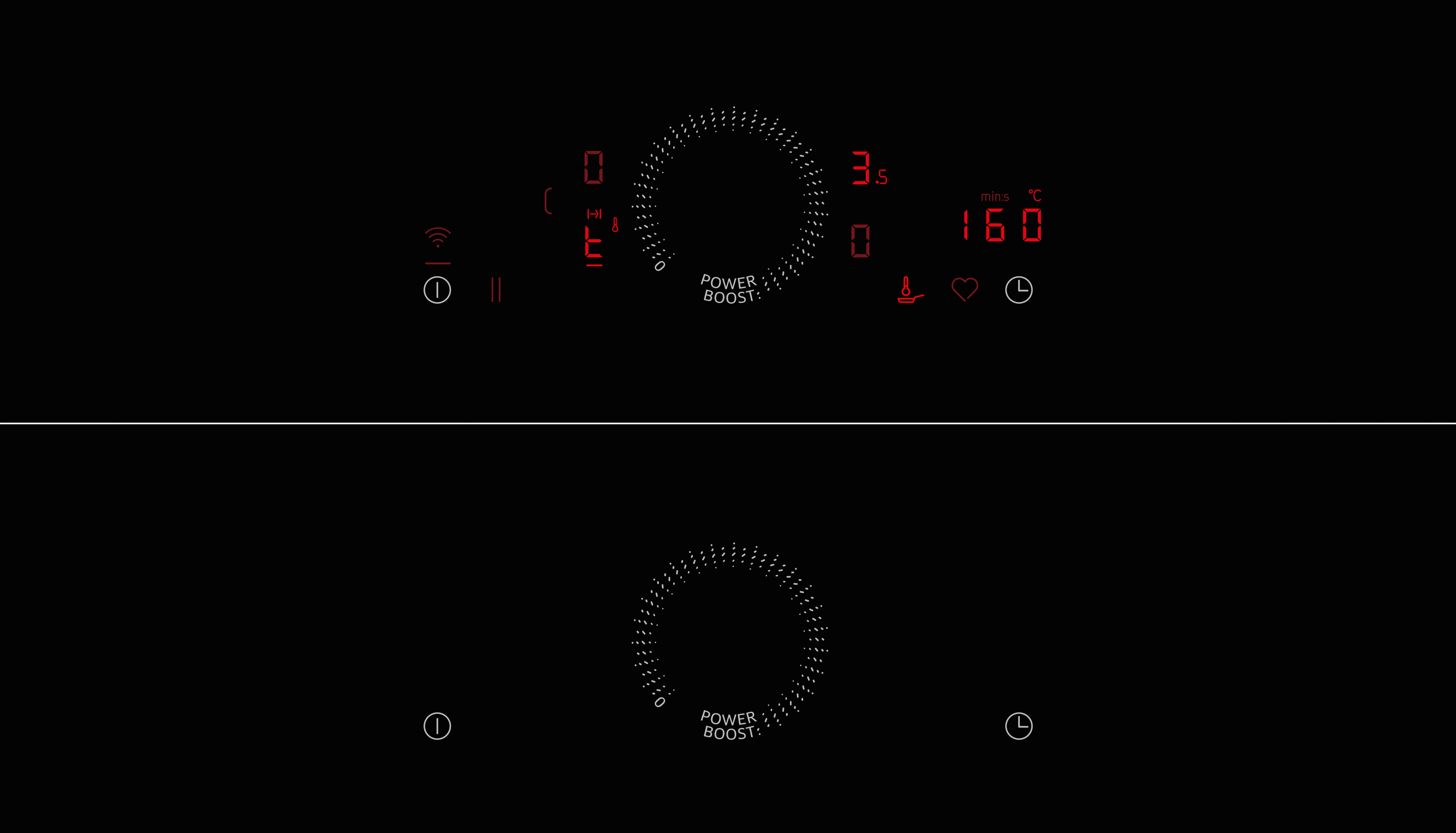

Posts: 13349
Our Neff is a combo touch/knob control system. On/Off, lock, temperature and extractor by touch. Removable magnetic knob to adjust cooking area heat if not using the constant heat setting.
One thing to remember is that the extractor is a massive heat sink in winter. Stick some insulation around it under the worktop to stop cold feet (ours extracts on a north-facing wall).

Posts: 14316
Posted by: nixie
Having knobs removes one of the benefits by making it harder to clean.
Indeed.  Our hobs are Neff and have a fairly clever magnetic knob that you just lift off for cleaning.
