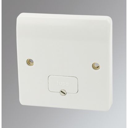

As long as the cable is clamped inside the outlet so that it can't expose conductors if you pull the machine out a bit hard then it'll be fine. You can see the cable clamp on the back of this one. https://www.screwfix.com/p/british-general-900-series-13a-switched-fused-spur-flex-outlet-white/86116
The only other problem is the lack of a local fuse that would be inside the plug top. You should see a separate fuse-holder either on the outlet or the remote switch above (if it has a switch, not all do). See also the example^^
Unswitched https://www.screwfix.com/p/british-general-900-series-13a-unswitched-fused-spur-flex-outlet-white/53282

Would normally look something like this, though presumably yours does not have FUSE written in big letters, otherwise you wouldn't be asking!

Is the dishwasher now connected to a fused connection unit / unswitched fused spur (back box and face plate with visible fuse holder)?
https://media.screwfix.com/is/image/ae235/29775_P?$fxSharpen$=&wid=414&hei=414&dpr=on

That ship has sailed however, so you just need to make sure there’s a fuse at the connection now.  This can be achieved with an unswitched FCU.  It’ll be a 13a fuse required for a dishwasher.
