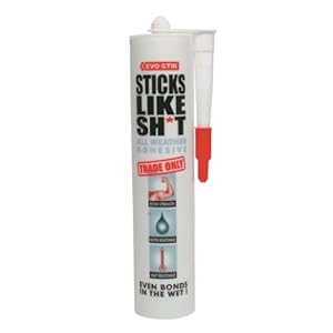

If you really want to do it, then go ahead, but if you can get a 94m deep batten in there, then you should have waaaay better options of where to site your TV. Mind you, where do you even get timber that's over 300 feet deep? ๐Ÿ˜‰
Anyway, this stuff will do the job, but only if you never want to get the battons off again without an epic fight and a lot of damage
Personally I'd be looking at a nice bit of furniture to put the TV on that also takes care of all the cabling
Posted : 29/12/2016 7:43 pm
