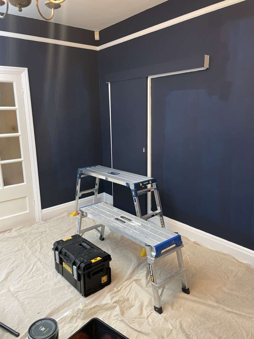

I’ve got a lot of work to do in our new (ish) old house which mostly has 9 foot ceilings. After starting on the 1st room I’m feeling a bit exposed on my existing hop up platform when it’s tall enough (Werner pro adjustable job, set about 750mm platform height) for me to comfortably work at that level. So was looking for something that makes it less likely I’m going to end up taking a trip to A&E.

The platform I have at the moment is only 120 x 35 cm and it’s not the end of the world moving it around while I’m painting. Just feels quite wobbly side to side and there isn’t anything to grab hold of to support yourself if your coming down next to a wall with wet paint on it.

I really like the adjustable Werner platform you have,nbut if theyre set to the higher settings you can perhaps feel a bit unsteady getting down from them if you have your hands full. So what I sometimes do is sit a regular hop up (which are usually about 450-500mm tall) next to it to give an easier step up and down.
The Werner 'Odd Job' hop up gives a nice big square platform compared to normal hop ups and is a really good companion to the adjustable height one (I sometimes sit on it and use the adjustable as a table for fiddly work) and gives a nice big and very stable step up and down. I wish they did a mashup of the two really.
Another option that would probably be still be cheaper than the Deltadeck and give you more flexibly would be a second adjustable Werner and just sit them side by side to give you more platform to stand on - or even span between them with staging boards. You can buy staging boards with handrails.

I have been doing something similar to your suggestion for an intermediate step to make getting on and off the higher platform a bit easier.
Still just feels a bit too wobbly for my brain to think it’s safe (being on carpet probably doesn’t help). Might see if I can pick something up second hand rather than get a new one.

What about 2 of the Werner platforms with short (1.8m) planks between? Then you end up with a 1.2m x 1.8m working platform . Can always put a sheet of ply cut to size on top of the planks if they are springy. Would also only need 3 planks then.
Or builders trestles and planks. You can get a handrail of sorts for them too.
In either situation use a step ladder to get on and off much easier than a smaller platform.
