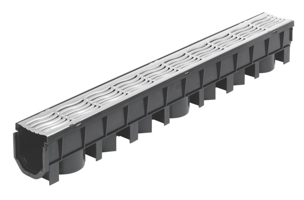

I'd put a channel drain against the full length of the house wall [url= http://www.screwfix.com/p/floplast-flodrain-channel-drain-galv-grate-black-silver-101cm-x-115mm/42589 ]something like this[/url]
[img] http://s7g3.scene7.com/is/image/ae235?$p$&layer=0&size=281,281&layer=1&size=281,281&src=ae235/42589_P [/img]
