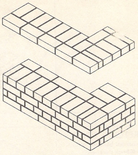

I'd be getting a brickie to do it.
The brickwork is one and a half brich thick laid English bond. Every course you cut through will involve cutting along the length of the headers ( the bricks which are laid so you only see the short end) This wont leave much of the brick once you make the cut, many of the old bricks won't survive intact and you'll need to patch it up to form a neat jamb for the new door.
I'd be knocking out the individual bricks and then patching up the edges rather than cutting it.

What if I was to cut along the edge of the headers PP?
There are headers and stretchers ( the longways ones) in every course alternating i.e
bottom course - Headers on the inside and stretchers on the outside
next course - Headers on the outside and stretchers on the inside.
[b]If[/b] the joint between headers on either side of the wall is aligned in each alternate course then that's where you'd want to make the cut. It's more likely that the joints on each side will be offset from each other .
Given the small area. I'd still be doing it with a hammer and bolster or a hand held breaker ( a big SDS drill with a chisel would be ideal) and taking out whole bricks rather than cutting it.
