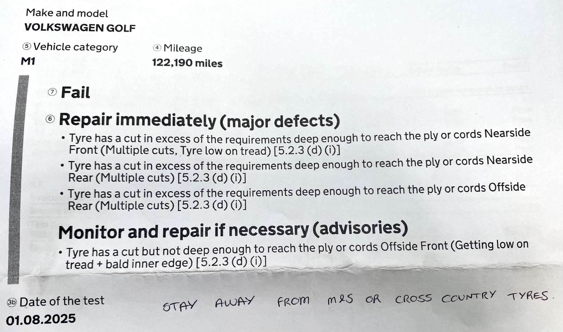

 IMG_4328.jpeg Just failed MOT for tyre damage. Fair, they have numerous cuts from stones.
but the handwritten note! Second time a mechanic has commented on my Michelin cross climates being unsuitable.
but after 4 years and 20,000 miles I think I’ll be ignoring the advice and ordering 4 new ones. They’re brilliant and I don’t understand why the motor industry insists on putting english drivers on summer tyres year round.

You know what, as I’ve digested this and done some googling, I think I’m being taken for a ride.
Aside from the cuts, the front tyres are noted as “low on tread”. I’ve just measured them with callipers at 4 mm, MOT minimum is 1.6. I like to keep on top of these things
ive just looked at my 2nd car which recently passed an MOT and the tyres are covered in similar small stone cuts.
inspecting my car after the MOT, yes, the tyres have picked up a lot of gravel, but that’s because (ah the irony) I drive home last night through heavy surface flooding and mud.
Does anyone else think that he just failed my MOT for the hand written reason “avoid M&S (mud and snow) tyres”?

Maybe he sees lots of mud & snow tyres with cuts?
I've got Pirelli Cinturatos and they definitely pick up more stones than the Goodyear F1s I have before.

Very odd written note!
Ignore.
Ignore.
the decision I’ve gotta make is do I need 4 new tyres or do I need a new MOT tester?
Posted : 01/08/2025 2:29 pm
Posts: 45993
Both judging by the MOT major defects.
Posted : 01/08/2025 2:33 pm
Posts: 5819
Am left wondering if this tester has never seen siped tyres before.
Go somewhere else,  this looks like they are useless
Posted : 01/08/2025 2:41 pm
Posts: 1834
You’re all allowed to laugh now - it’s Halfords.
Posted : 01/08/2025 2:43 pm

Huh? The OP said their tyres actually are covered in cuts though?
I can't see any reason for the MOT person to write that kind of note except to be helpful, and as I mentioned mine do pick up a lot of gravel (and therefore cuts) too.

We can all see the photo but have you tried MOT tester protocol and seeing if the sipe have indeed torn open to the cord. A good hard look and a photo will not show that.
When assessing cuts in a tyre, it is permissible to check whether a cut is deep enough to reach the ply or cord by using a blunt instrument to open the cut taking care not to cause further damage.
The following criteria should be used when assessing a cut in a tyre:
  • any ply or cord that can be seen without touching the tyre - fail
  • if by folding back rubber or opening a cut with a blunt instrument, so as not to cause further damage, exposed ply or cord can be seen irrespective of the size of the cut - fail
Posted : 02/08/2025 4:47 pm

Just seen the hand written note - never noticed it on the bottom of the test cert.
Halfords you say.
Might want to let head office know about their testers giving out hazardous advice.

Seems like standard Halfords’s form. Surprised it doesn’t say your brakes are in need of replacing shortly.  I’d be speaking to VOSA and / or getting it re-tested. A fail like that could make a prospective buyer think you neglect it.
DO NOT DRIVE YOUR VEHICLE. A fail on an early MOT overrides the remaining certificate, ANPR could easily catch you out and it’s just not worth the hassle of the points, a fine, potentially having the car seized and the subsequent insurance price hikes.
As others have suggested pry the sipes open and have a good sqy inside.  Sharp end of a bike tyre lever  will probably get them open.
Gut feeling is the tester’s a knacker, wants shopping to vosa and halfrauds  via social media. This is exactly the reason test certs have no free text fields.

Re OP, those look fine but definitely needs MOT elsewhere before thinking of driving anywhere.
