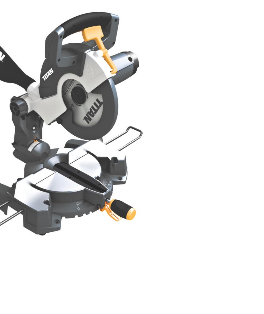

Im using my chop saw a lot at the moment - making treehouse for Jr.
But equally to rip the WBPly floor I needed the circular saw. Without one would have been a ball ache.
Despite being cheap and crap, Ive had loads of mileage out of this £95ish:
[img] http://s7g3.scene7.com/is/image/ae235/32315_P?$p$ [/img]
http://www.screwfix.com/p/titan-ttb234msw-254mm-compound-mitre-saw-230v/32315#
