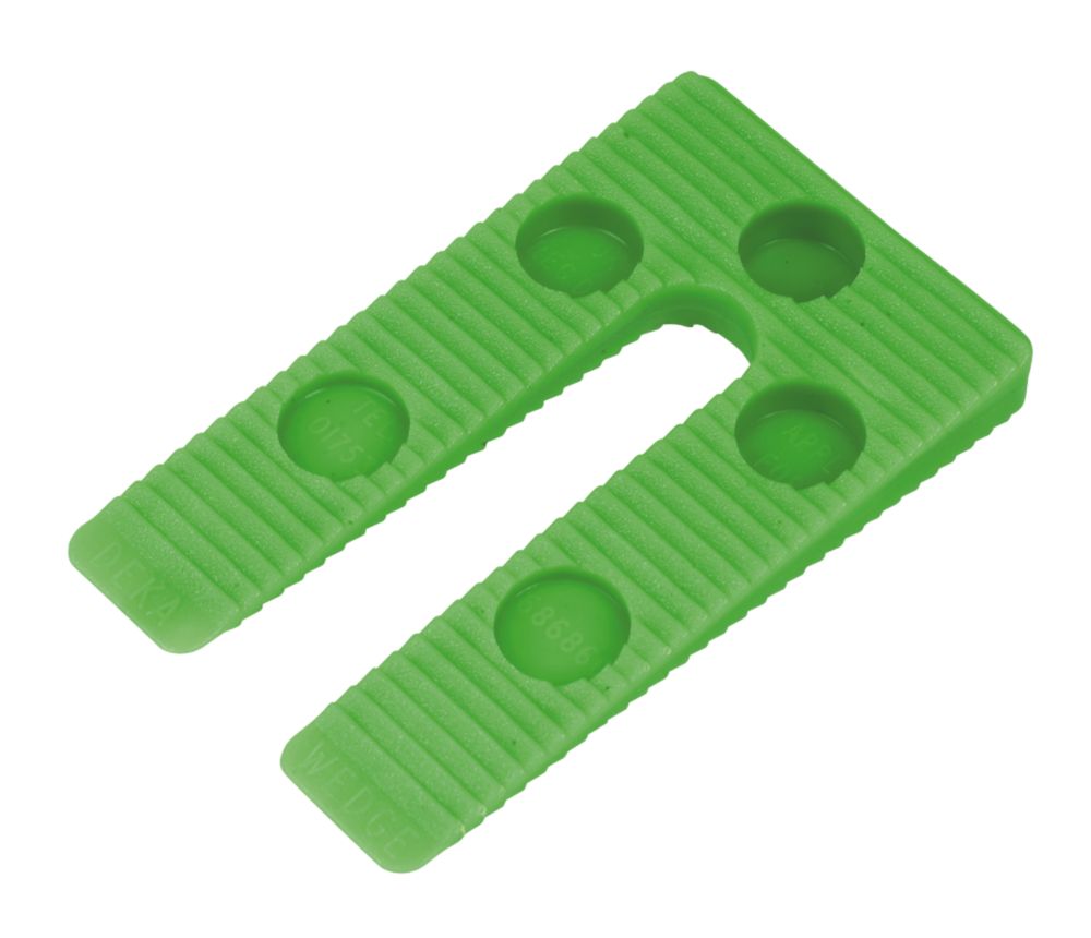

When I was placing Kingspan between joists at a previous house I used spacers to hold the boards, which I undersized by ~25mm on each dimension, before foaming the boards in, removing spacers and then foaming up those little gaps remaining. Joints were all foil taped to span the joists with really wide foil tape of ~75mm.
The spacers were the below. Totally indispensable to me whilst dong this job!
spacers
Crickey..... why?
When I did our I just cut each one to size, foamed any gaps then foiled taped everything.

Posts: 98
why?
An old house where joists were all relatively irregularly spaced and not always parallel to their neighbours, exactly, mean that a 12.5mm gap all the way around made the whole situation workable. I started trying to be 'ideal' with my approach but this soon changed. Undersize, wedge, foam, de-wedge, foam, tape.
Posted : 25/11/2021 2:59 pm
