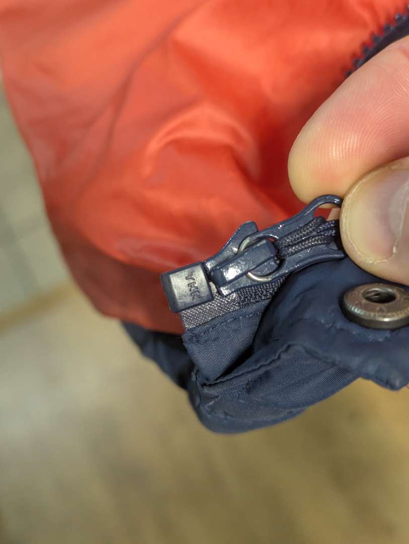

This is my favourite Rab jacket. Someone who shall remain nameless closed a door on it and crushed the zip.

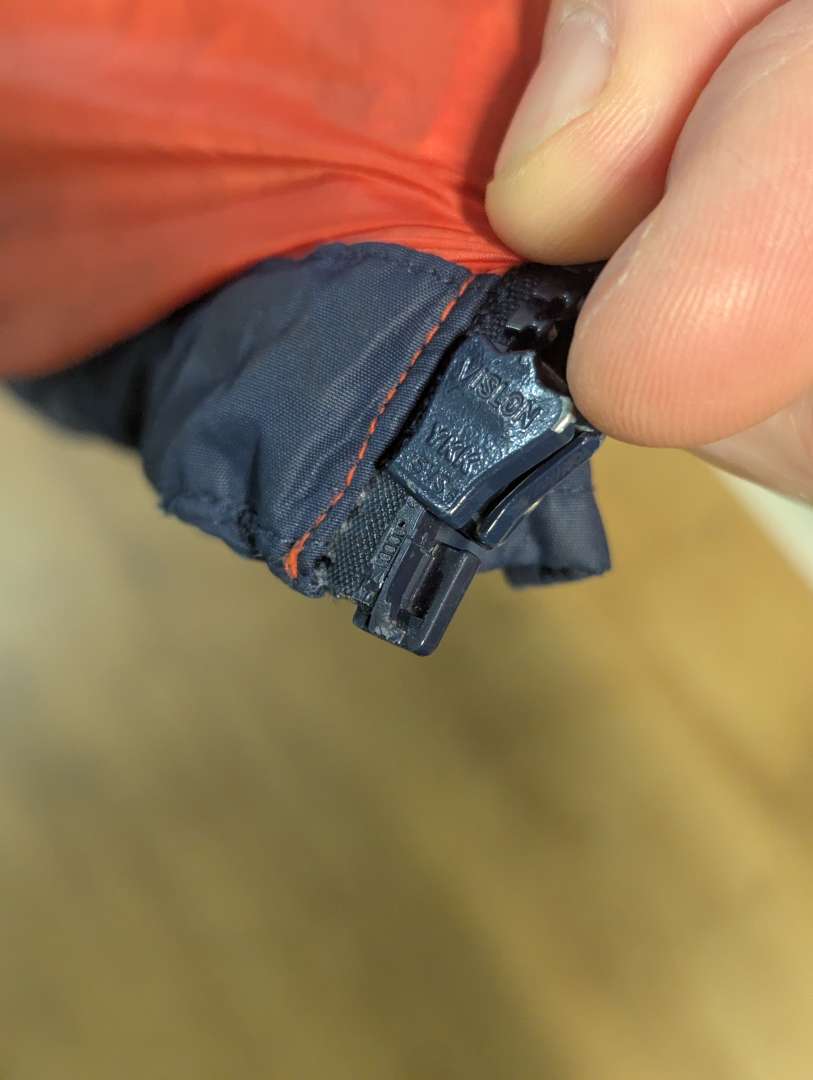

As you can see the plate from the back has broken off and now there's nothing to hold the 2 sides together when you start tugging.
I don't know anything about zip mechanics. Is this fixable? It's not really useable in this weather with no zip.
Front. Fine.
Back. Broken.

A lot of people talking about replacing the slider/puller when that's not the bit that's broken.
Posted : 23/01/2026 2:13 pm
Posts: 9065
The slider and teeth are fine. Google tells me it's the 'starting box' that's broken and the name makes sense.
I was hoping for a DIY kit or spare part but I've discovered a local-ish outdoor clothing repair place that I can try.
There's also the Rab service centre which I was hoping would be in Sheffield but is actually Northwich.
Plenty of options. I'm not binning it yet it's in otherwise mint condition.

From what I could see in the photo, it’s a weatherproof zip with a hard cover over the teeth that closes up tight behind the actual zip in order to prevent water seeping or being blown through the teeth. That’s a complicated design that needs a specialist seamstress who knows how those things work, so best to send it back to the people who are intimately familiar with the process and can do a professional job of repairing it. Considering how much a new jacket can cost, £40 or thereabouts or even £50-60 is worth paying to get years more wear from it.
