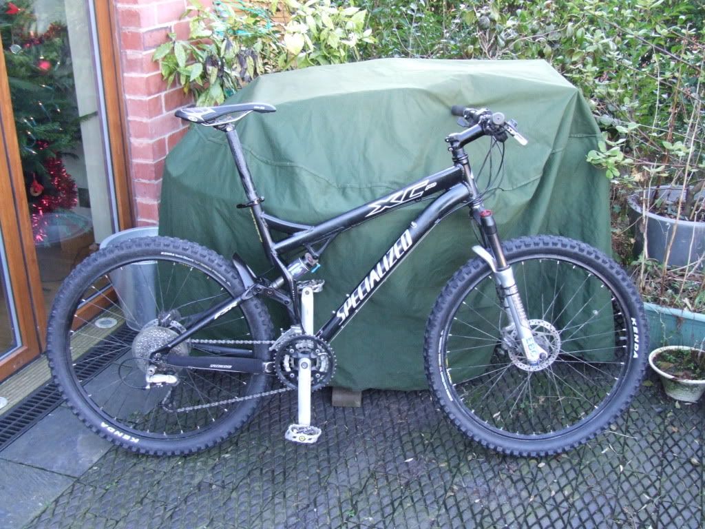

Posts: 23315
Ignore the bike. Look at the drain infront of the folding doors. This is what we had to fit in 2004 to conform with building regs.
Have a chat with building control at your local council.
