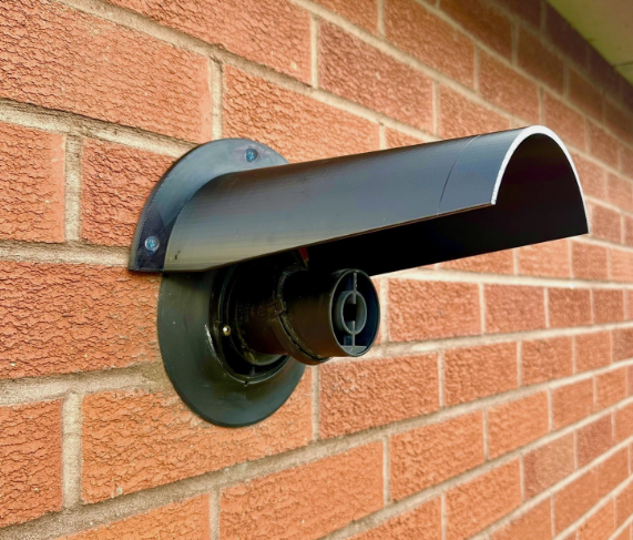

After a previous episode I fitted a cowl like this (not my flue, but pretty much the same):
...but today is proving that it's not effective, cos the wind and rain are howling and water is dripping out of the boiler.
So, ideas?

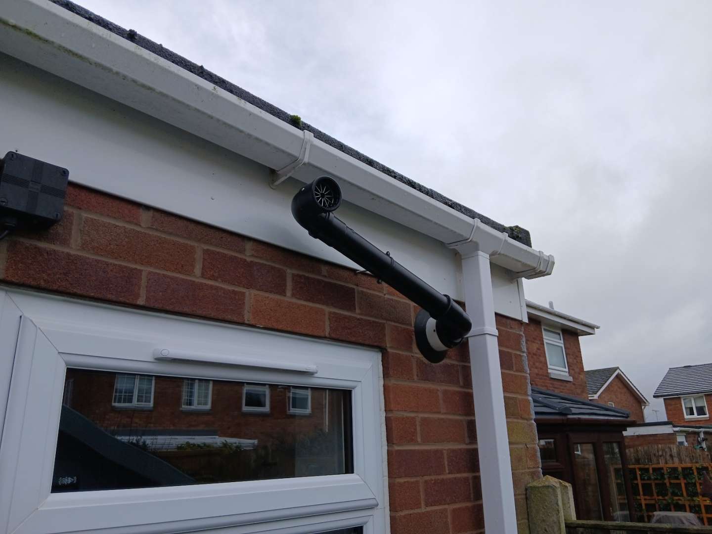

Some sort of zigzag bend, similar to this, but much shorter and routed downwards?
We were advised to put this in 10 years ago because the main outlet was quite close to neighbour's property, so it redirects the exhaust gases into our garden, not his. I was concerned that the gases would burn a hole through the pipework, but was unfounded - it's been no problem in that time.

Yeah, that's kinda what I'm thinking. Thing is though, the flue is like a 'pipe within a pipe', the centre pipe that the gases come out of being the 'sticky-out' bit and the outer pipe, which I presume is for insulation, terminates flush with the wall. I'm pretty sure that the rain is coming into the outer bit, and extension pieces like yours seem to attach to the inner/sticky-out bit only.

Thread revival time. I've checked the installation manual and the boiler can have a vertical flue, so that may be an option.
However, I've had an idea...
I have the original cowl (the on I took off to replace with the 'rain stopping' one from the picture above). It's one of these boggo ones:
So, my idea is to get some stainless steel mesh sheets and wrap them over the top half of that cowl to form a sort of 'cap' and place some on the flat end, which is the end that faces the weather, as the rain can essentially be horizontal. The mesh has c.1mm 'gaps', so I'm thinking this is enough to stop (at least most of) the rain blowing through it, but is not too small as to impede the boiler exhaust gases (plus it'll be a distance away from the end of the flu anyway).
Is this a good idea, or a stupid idea?
