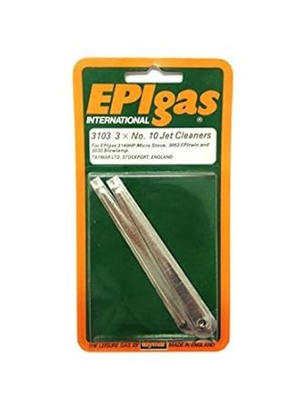

You need a gas jet pricker, it is a super fine 'needle' that will poke in the jet and dislodge the blockage. You might get some in an outdoor shop or hardware store, or online obvs. Worth having to keep in your spares kit

yes, gas pricker thing, pretty sure I've just fashioned something in the past out of fuse wire or a pin or a strand from gear cable or something

Fuse wire. I keep some wrapped around the inlet pipe so it is always to hand.
