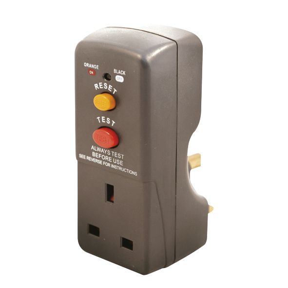

It's fed via about 20m of heavy extension cable plugged in to one of these.
[img] http://s7g3.scene7.com/is/image/ae235?$p$&layer=0&size=281,281&layer=1&size=281,281&src=ae235/63731_P [/img]
The data plate on the motor says 11/5.5 amps.
I'm guessing that's maximum load and off load consumption, although it seems to have a two stage switch of some sort, as it starts off slow, then suddenly kicks in to a higher speed after a few seconds, so maybe it's a higher starting current.
If the motor is only 11A, then I'm also guessing it's the added resistance of the 20m extension cable that is causing it to trip
It runs fine for a long time cutting tiling laths, but after a while, anything bigger trips it out.
It's a normal 13A household plug on the saw. I really ought to upgrade it with a weatherproof NVR switch and emergency stop button.
The obvious answer to me is to run two 13A extension leads and RCD adapters in parallel wired in to one NVR switch in the saw.
No doubt, this won't comply with any official code of practice, but is it actually dangerous?
Is there a safer way to do it?

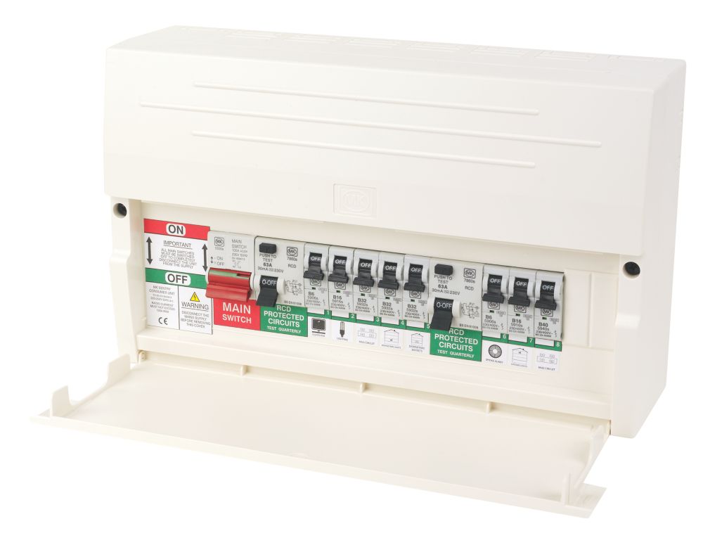

What if I was to buy;
This [url= http://www.screwfix.com/p/bg-20a-single-pole-b-type-mcb/22963 ]MCB[/url]
This [url= http://www.screwfix.com/p/wylex-ip40-insulated-enclosure/32311 ]enclosure[/url]. Is it compatible?
This [url= http://www.screwfix.com/p/ced-240v-extension-lead-blue-2-5mm-x-14m/23418 ]extension lead[/url]
This [url= http://www.screwfix.com/p/ced-240v-2-pin-earth-blue-plug/20201 ]plug[/url] for the saw
This [url= http://www.screwfix.com/p/mk-commando-interlocked-angled-socket-2p-e-16a-200-250v-ip44/40962 ]socket[/url]
This [url= http://www.ebay.co.uk/itm/Start-Stop-Switch-No-Volt-Release-Switch-NVR-2HP-16A-with-Emergency-Stop-/151476318780 ]NVR switch[/url], or probably search for a waterproof one.
Then wire it all in to my existing 20A fuse, until I get around to fitting a proper consumer unit?

What trips? The fuse in the plug, the RCD or the MCB in the board?
The RCD. The 20A fuse on the board and the 13A fuse in the extension lead and saw are OK.
Don't those things just protect against an imbalance of current and not trip on level of current?
Dunno, this is where I'm out of my depth.
I just assumed it was like a resettable fuse and if it's rated at 13A, then it will trip at a higher load.

MCB isn't tripping, so no cable overload in the house. Fuse not blowing on the plug, so no overload there.
RCD trips implies an earth fault. Not sure if there is an RCD in the house protecting the circuit(?). The most sensitive RCD will trip first.
If the circuit has a 30mA RCD protecting it on the main board, take the plug in RCD off and try the saw. If the house RCD goes, it will eliminate the plug in RCD and confirm an earth fault. If there is no house RCD don't do this, but try a different plug in RCD to see if the tripping persists. If not, then it's a faulty RCD otherwise you still have an earth fault on the saw.
The RCD at the plug tripping indicates the fault is between the RCD and saw as the RCD would not trip with a fault "north" of this.
If an earth fault is suspected, power off and check for a loose neutral connection in the plug and also at the saw. Heavy load could be causing an increase in temperature in the RCD. Not sure whether there is a thermal cutout in the RCD or whether an increase in temperature could make it excessively sensitive.
Failing that, I would have the saw and extension cable tested to ensure that the LN-E Insulation resistance is satisfactory.

Running an 11A motor through a 20A fuse isn't overloading anything. I put the 13A RCD in for additional protection and that's what's tripping out exactly as it should.
Or perhaps not exactly, if Trail rat is right about them becoming over sensitive with age and use.

16A RCD then.
Edit: but no higher unless you are sure everything is wired with 2.5mm2 cable.

Anyway, I'm off to Screwfix now for a new consumer unit and some other stuff to try and tidy that mess up.
Sounds like a good plan. It's amazing how cheap the CUs are fully loaded with MCBs. You will spend half that on a couple of new plug in RCDs.
I'd fit a few dedicated high current outlets (like the blue one above)
Get some new wallpaper while you are out 😉 😀
Posted : 06/12/2014 6:24 pm
....and some 16mm singles, 10mm for bonding. Seals for the main fuse will be available on ebay.....

OP: You may have a neutral to earth short in your extension lead or the saw. It will trip the RCD when the voltage drop down the neutral wire is enough to send 30mA down the earth wire, but not otherwise.
RCDs are not omnipotent - it will only trip when there's electricity going up the "live" and not coming back down the neutral. Load, extension lead length, voltage surges and phase of the moon are irrelevant.
Believe your RCD - it is telling you there is a fault. All you need to do is find it. (Megger meter would be handy).

I bought [url= http://www.screwfix.com/p/mk-sentry-16-module-10-way-dual-rcd-consumer-unit-with-8-mcbs/40025 ]this[/url] from Screwfix and wired it all in.
[img] http://s7g3.scene7.com/is/image/ae235?$p$&layer=0&size=281,281&layer=1&size=281,281&src=ae235/40025_P [/img]
The consumer unit is fed from a 30a bakelite fuse in that metal fuse box, top left, in my picture above.
I've then wired the extension lead to a 16a MCB.
As soon as I switch the saw on now, it trips the 63a RCD.
Is this likely to be a fault with the motor, or is there a less sensitive RCD or some sort of soft start switch I could buy that would cure it?
Posted : 30/12/2014 10:56 am
