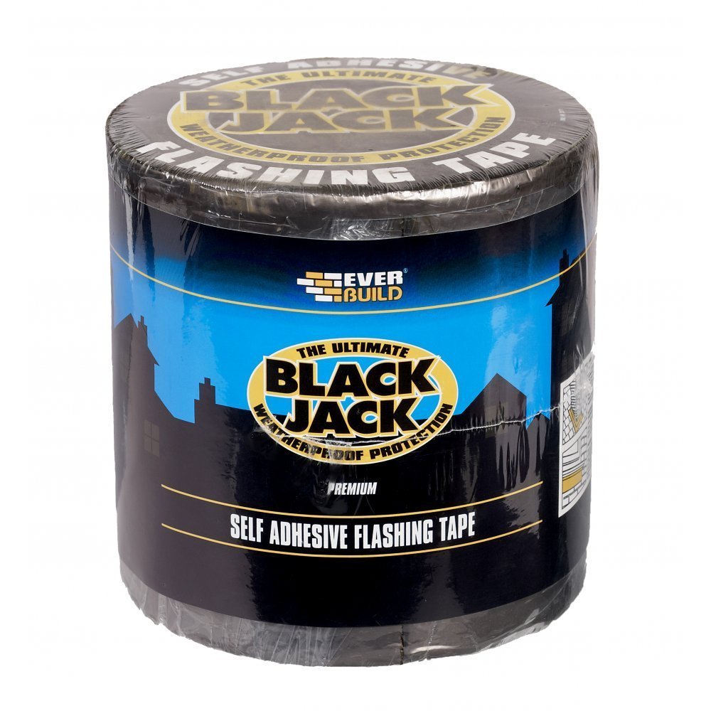

I started with this...
It's a fraction of the cost of Dynamat. It just adds mass to the large flat panels and stops them vibrating like a big drum. It drastically cut down road noise and while it's not real insulation, it's not as cold to the touch as steel.
