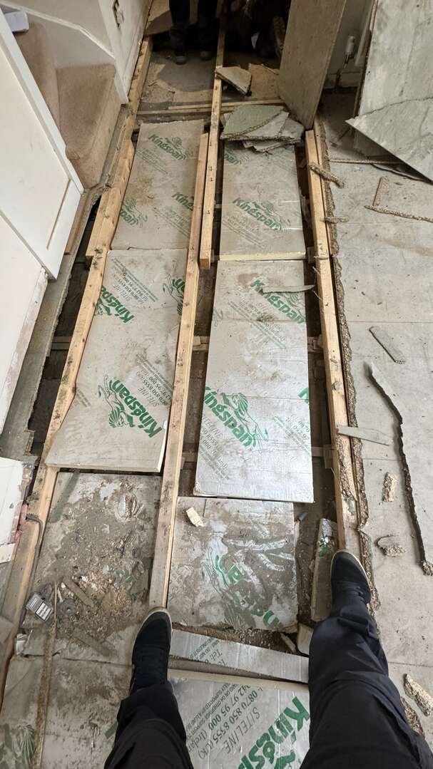

1. All the stop cocks for a downstairs bathroom and heating hidden under the floor with a engineered oak floor on top and a toilet installed. Some leaking naturally.

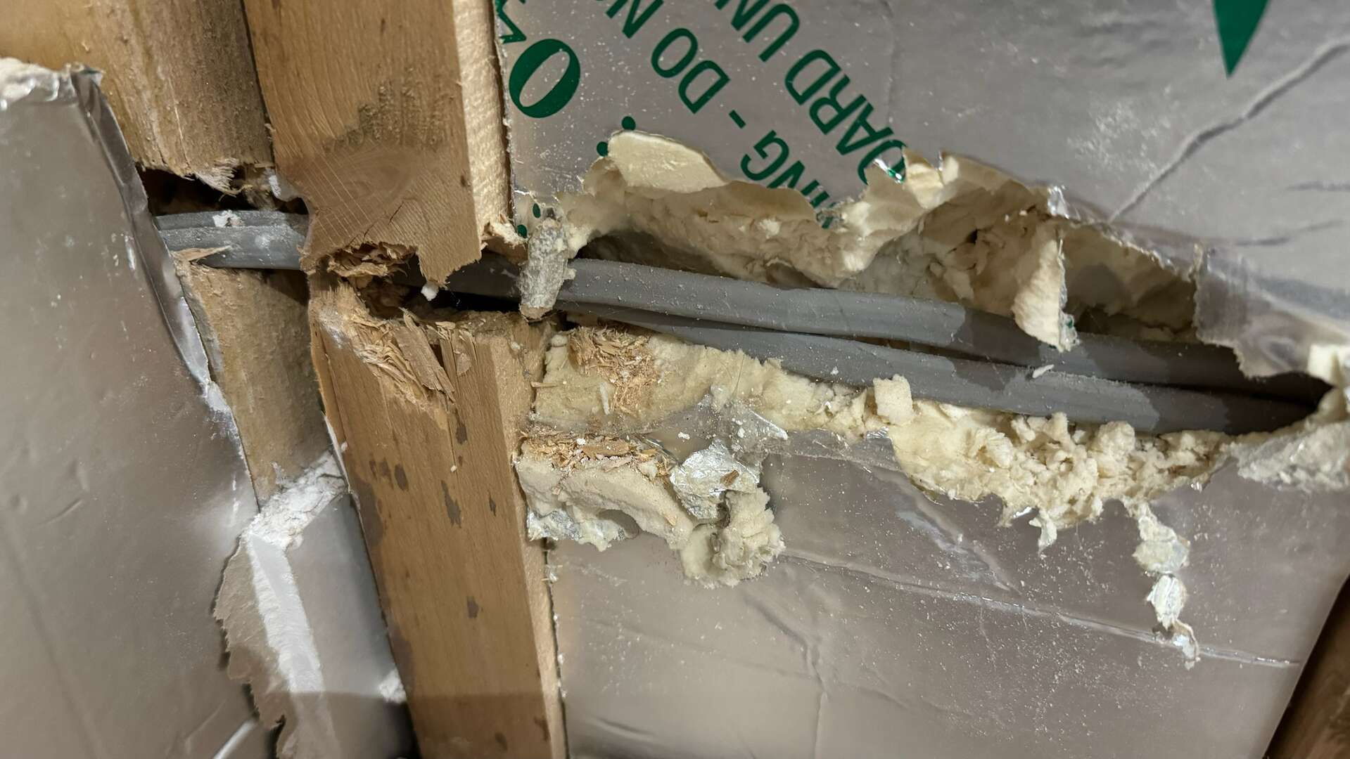

2. Waste pipe sloping the wrong way so sewage pools under the shower - shower waste trap installed with a part missing to let odours in of course. Shower leaks -  see #4

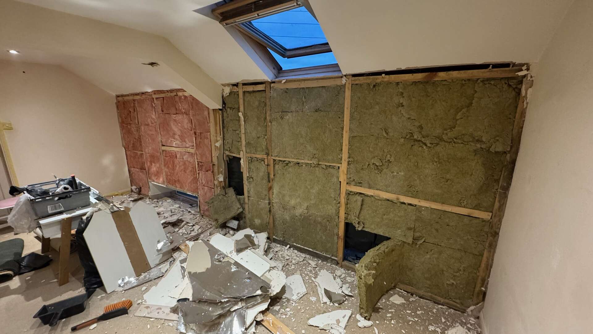

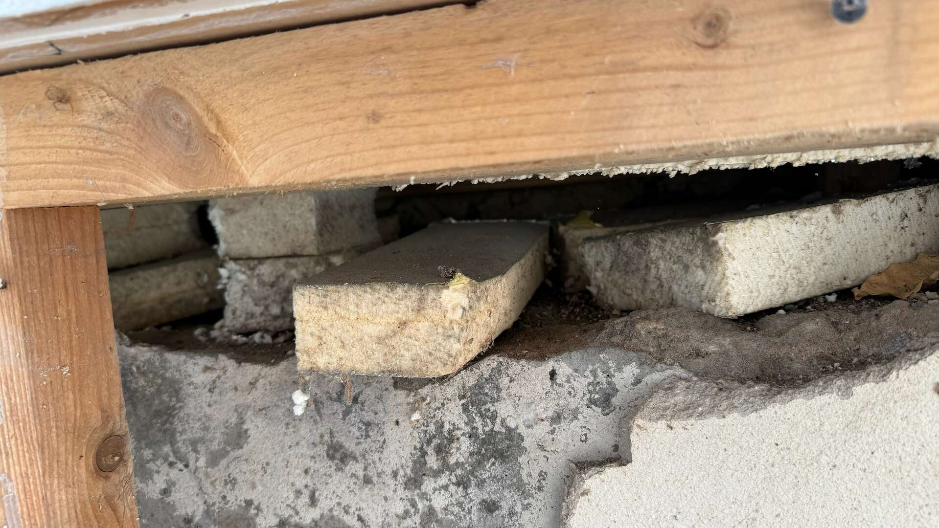

3. Opening widened to fit a small porch leaving a large load bearing lintel sitting on about 1cm of stone. Excellent work dickheads.
4. Deliberate removal of joist support to create a slope in a floor - don't ask why, this post is long enough already. Plenty of rot from joists sitting on damp ground.
5. Old doorway bricked up but didn't bother to support the bricks above that have now sunk into the void above the new block work because you couldn't be arsed to rake out a bit of mortar and point it up. All plaster on that wall a mess of cracks.

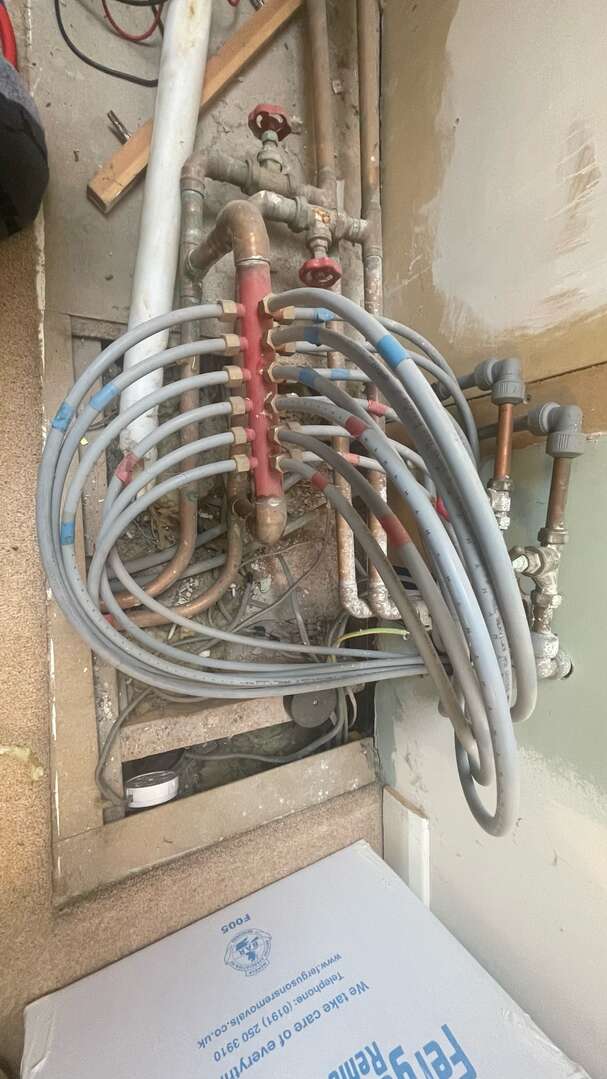

unique plumbing
It's not the neatest, but using a manifold makes a lot of sense with plastic pipe - no joints you can't access so nowhere to leak.  You're also not splitting a pipe feed between 'things' so less pressure loss across taps.
I did ours with a manifold behind a bookshelf and a shutoff valve on each pipe.  It's easier just to turn off the main supply if it's something you can fix quickly though, only bother taking the books off the shelf if somethings going to be isolated for a while
