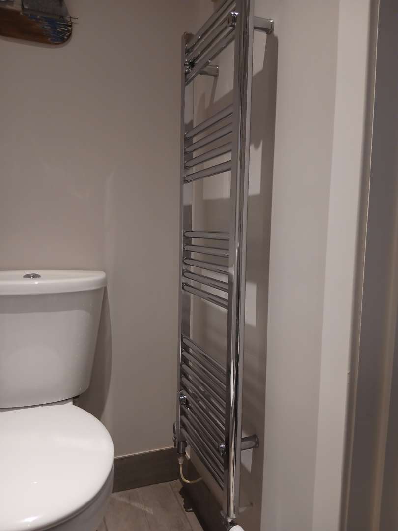

Posts: 1475
Posted by: BigJohn
We have heated towel rails connected to the central heating in both the shower room and the bathroom.ย  Both were chosen for looks and a convenient size, rather than any heat output calculation
Same here. The one in the bathroom is fine for heat, but I'll admit the one in the downstairs cloakroom (photo below) struggles to keep that warm, probably related to the fact that there's a pipe vent in the ceiling associated with the extractor fan.ย

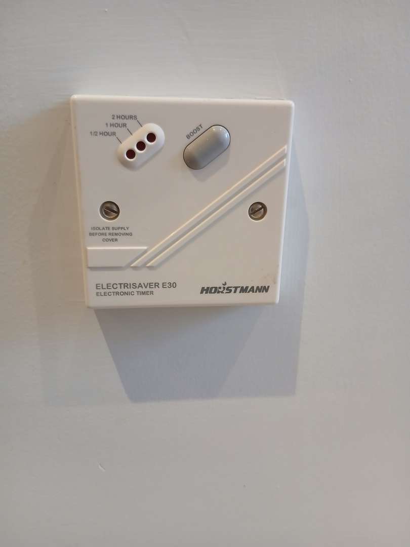

Also, both have an immersion element in them, in turn connected to a timer switch on the other side of the wall. You can see the wire at the far side of the rad. I dont think you can get this particular model of switch now, but there must be an equivalent alternative
