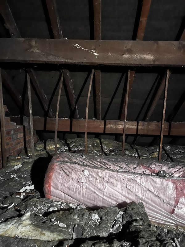

I have recently bought a property and decided to poke my head into the loft yesterday and noticed a couple of the supports bending - I am by no means not a roofer but I wouldn’t have said they are supposed to be bending. It wasn’t something the building surveyors mentioned or raised as an issue either.
Does anybody have any advice before I get someone in?

those are not roof supports but ceiling hangers to prevent the ceiling sagging.  they are hanging from the roof in tension not supporting it in compression.  nowt to worry about.

Looking at the thickness of those they aren't supporting anything!
No idea why they are there to be honest - may be a previous occupants addition. Or they could be holding the ceiling below up!

TJ has it.

Definitely ceiling hangers - they "help" if the ceiling joists are potentially undersized.
Victorian house by any chance?

(We flipped a terrace house where the bedroom ceilings bowed when we tried to overboard and skim them despite the ceiling hangers)

Most of the ceilings are okay, we are having one skimmed though so will bear that in mind cheers. Yes it’s a Victorian end terrace built around 1890 and was the old station masters house (the station is no longer there though)
