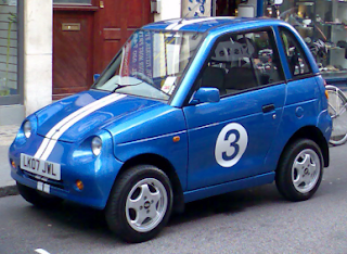

People, please don't encourage him. He's not called 'WorldClassAccident' for nothing you know. 🙁
Why can't you just get something like this?
