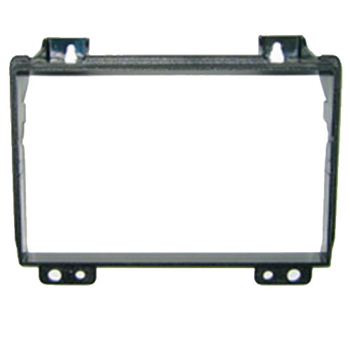

Lots of double DIN head units, but often they require an additional facia surround specific for your car, like this:
From [url= http://www.dynamicsounds.co.uk/double-din-facia-ford-c-47_741_753.html ]here...[/url]

Point to note: your Focus is [u]not[/u] double DIN, the Ford head unit is slightly bigger. You can fit a double DIN unit with the appropriate adaptor plate.
Posted : 22/08/2012 11:30 am
