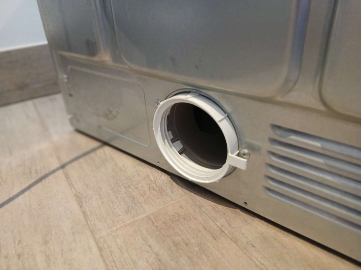

There's certainly a female thread on the inside of the vent pipe, along with a small bayonet, as per picture below. Whether those are for securing the flexible hose, or to fix another (now missing) part of the machine, isn't clear.
Ah well, thanks all. I guess it's just going to be a case of  'stuff some in and duct tape' then hope for the best again.

Not sure if I'm understanding this properly but what if you take out that threaded collar and then put the hose through from the other side will the threads match up?

@avdave2 Nice idea, but it'd be a right bugger to remove that - it's got 4 or 5 clips holding it into the steel frame, which would be hard to access and clearly aren't intended to be got at. The thread is only 2 turns deep anyway, doesn't go right the way through the collar.

Jubilee clips etc wouldn't work unfortunately - the vent pipe goes inside that plastic collar, it's not big enough to fit outside it. The zip ties that came with it have ended up in the toolbox spares.

Not sure if it's just the way the light is falling on that image, but it doesn't look like a left-hand thread to me, it looks standard RHT

Yeah, sorry, you're right now I think about it again, the collar there is right-threaded. But by contrast the vent hose thing is effectively left-threaded, so whatever way they are, they're not compatible with each other. Hence the end result has been 'cram a couple of inches of hose inside, and bosh some tape on it'.
Seems to have done the job so far, and theres noticeably less whiff of damp warm air in the room than there was last week from the old, possibly split, hose. Result, I think.
