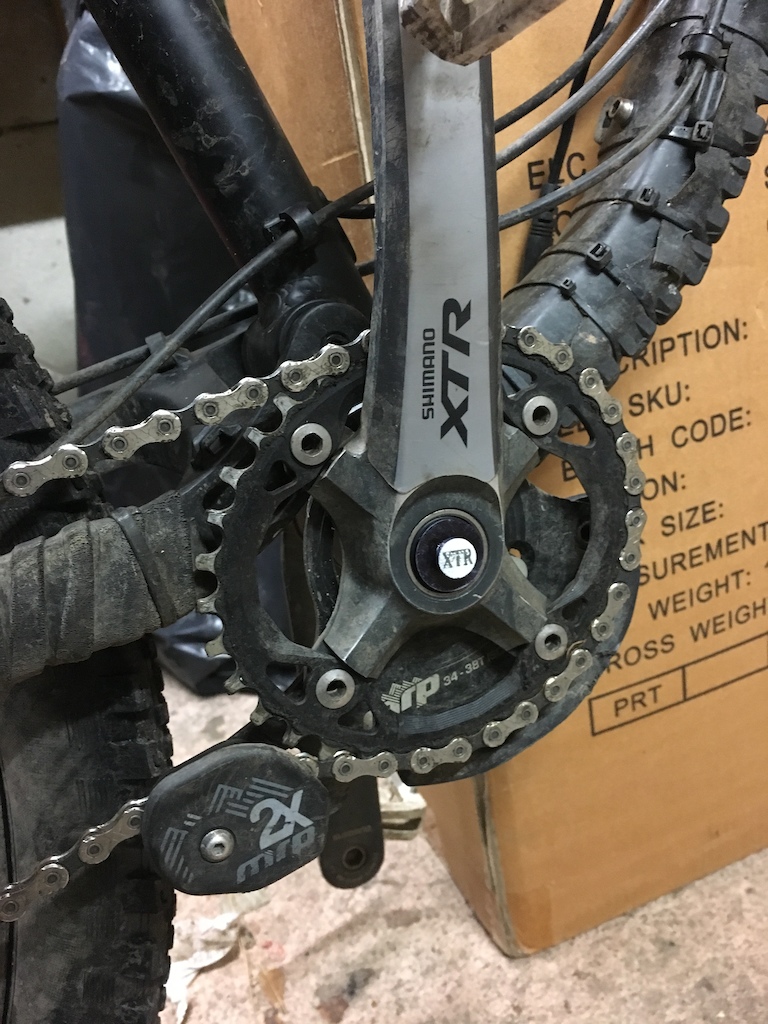

latest attempt at something functional;
Top to bottom; Initial prototype - Test prototype - Working prototype
The initial modelling took 2-3hours in TinkerCAD, with the tweaks in-between taking 30-60mins. Print time approx. 4hrs for each prototype with a 40% fill and 1.4mm shell thickness.
The "put it in a vice and smack it with a lump hammer as hard as you can" test on the first prototype caused it to delaminate slightly, but that was expected tbh.
Will ride this for a bit and see if it needs anymore tweaking then print out of black PETG, probably  with 100% infill.
