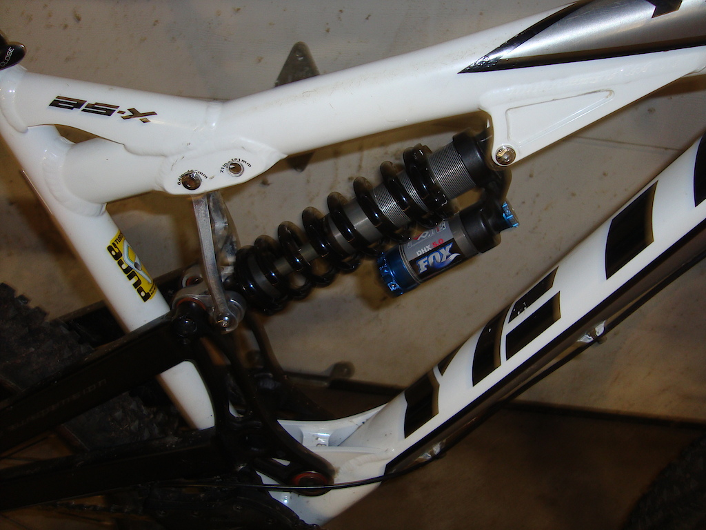

which hole is which?
IIRC the difference is something like 6.5" vs 7.5" of rear travel using an 8.5 x 2.5 shock, with the longer travel setting also resulting in a slacker head angle by about half a degree.....
thing is that i cant remember which hole is which
anyone know?

nah, i scoured that at the weekend to see if i could find anything - it does however correct me a little, its 6.4 & 7.1 travel and its 0.5deg seat angle and 1.0deg head angle...
yeti kindly put a note next to the bolt holes to define the travel, the merc garage kindly painted over it.... and the seat tube badge - gits.

front hole is the longer travel, rear the shorter one ๐Ÿ™‚

but from the diagram on p.5
if the link is attached in the front position, i imagine the headtube to be slacker, which from the table seems to match the shorter travel setting....
short travel, slacker, lower BB - thats the one
or is it?
edited post gazc: dammit

I'll have a look at mine when I get home, but I'm pretty sure the one closest to the head tube is 7.1 travel.

Looking at this the front hole is 7.1 inches and the back 6.4.
Big version available here - http://www.pinkbike.com/photo/5984878/

i stared at that pic for ages, wondering how on earth you can read that printing
then i spotted the 'description'
cheers all.
its the rear hole i want then!
