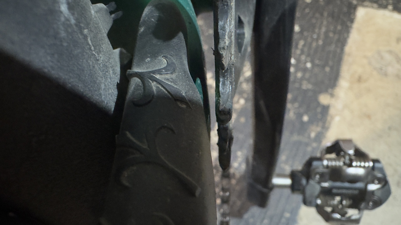

In the last 2 years I have been lucky enough to be able to afford 2 very expensive push bikes ie both have been £6k +
But the service Ive had with both has been appalling. This is the latest issue I am now stuck what to do.
I bought a new gravel bike maybe 6 weeks ago. Even during the bike setup (fit) the chain kept dropping. Shop owner just said the chain needed to 'wear in'.
5 weeks later and 300 miles, go back to the shop. Owner checks the SRAM Force setup and says it wasnt setup quite correctly from distributor and now the best he can do, anymore issues speak to the distributor as nothing more he can/will do.

Posts: 16270
In any of the 4 larges cogs at the back, and you are not pedalling forward the chain roll backwards to mid cassette jamming everything up.
It makes steep hill starts near impossible as you cant turn the crank to the right position. If you get off the bike and go through a gate by the time you get to the other side of the gate or slightly roll the bike back to shut the gate it jumps down the cassette (with gear still in largest cog setting)
Climbing up steep hills its very loud, louder than the noise from my ebike motor

Posts: 16270
https://youtube.com/shorts/19cVloLcTow?is=I0HvCgn42Xb1ekaI
Now obviously this the bike suspended on a wall and me turning the cranks backwards but it is the same out on the trail.
The rear mech is in the position to keep the gear in the largest sprocket. Yes I know a mech is a guide for forward movement, but the slightest back pedal does this
Ive wondered about a ‘sticky’ free hub. If you back pedal in a lower gear there is some rotation of the wheel.
But no way am i stripping a brand new freewheel on a brand new bike that should be working
Agree all leads back to the shop I bought it from

Posts: 9834
It can happen off the largest sprocket on bikes with short chainstays that create a bad chainline in that gear. A stiff freehub creating chain slack can makes it worse.
Posted : 27/08/2026 2:19 pm
Posts: 16270
It does it on the top 4 !
Posted : 27/08/2026 2:23 pm

Google tells me that is a chain line issue. When you are pedalling forward it is fine because the mech guides the chain onto the cassette on the right sprocket. However, when pedaling backwards the chain is guided on in a straight line from the front sprocket. In this case it looks like that angle is too severe so dropping down.
https://www.reddit.com/r/bikewrench/comments/1eydoxp/chain_falling_down_to_smaller_cogs_when/
https://www.mtbr.com/threads/chain-falling-to-smaller-cogs-when-backpedaling.1197756/?utm_source=google&utm_medium=organic
I don't know if there is any option to alter the chain line at the cranks. Move it inward so it "favours" the larger sprockets at the back.
In any case, that shouldn't be happening. They should fix it or provide an acceptable solution. My guess is they are dragging their feet because they don't know what to do and don't want to take the bike back.

^ that is rubbish .. the wider and larger the cassette and the shorter the chainstay the more common it is. Some will say 'just don't back-pedal' but it was a PITA on my bike when climbing anything ratchety and steppy (1x10 on an old bike with a short stay 135mm rear end, not a new bike). The problem seems to be there's nothing you can do with mech set up that stops it, you can only move the chainring across a bit to reduce it. Maybe there's a top mechanic's tip to be had from someone.

I suspect someone somewhere has fitted the wrong BB or put some spacers in the wrong way around and the chainline is off. I suppose there's a very slim chance that the frame itself is out of alignment but whatever it's not fit for purpose.
If the shop you bought it from won't / can't deal with it, take it to a reputable workshop then see the options for it being covered under warranty or charged back to the original shop.

I have found that a 52 tooth cog, particularly with shorter chainstays, doesn't like back peddling. I've returned to/stuck with 50 tooth cassettes and had no problems.

What's the chain line like ? Other question, is the correct chain installed. Definitely a shop responsibility, but I wonder if other 13 speed mechs are presenting with that issue (and on that model of Willier) with the slightest back pedal.

https://youtube.com/shorts/ZYHW2gkygpo?is=bImCnSvX3VaWo83L
The vid is in the correct ‘setup’ cog. Back pedal turns the rear wheel and feels lumpy
I have no idea how you look at chain line , but the front ring could not be moved further in board (photo) prob 2mm clearance
It’s a KMC flattop chain. Now of course SRAM told me that it should be using a SRAM. Apparently it came out of the box with the KMC
I've got a KMC flattop on a SRAM Force 1x12 AXS and it's been perfect. They work fine but obviously SRAM will say it needs a full Force groupset including chain.
It'll be a cost cutting measure, I'm sure if the manufacturer are buying 10,000 chains, it'll all add up.
