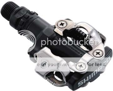

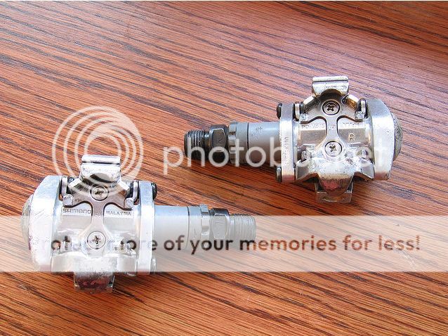

Posts: 7612
Really? I think you're overstating the problem slightly. I've had M520s for the past 5 years or so and can think of maybe one or two occasions where I've struggled to clip in due to mud or snow. With Time ATACs those may well not have happened but for the 10 seconds I'm not sure I'd go as far as calling them "shite".
I guess it depends whether you bothered to consider the phrases "really basic" and "open design"
Here are some pretty pictures to help you out:
Shite: (not open design - really basic)
Pretty good: (open design - still basic but decent pedals)
