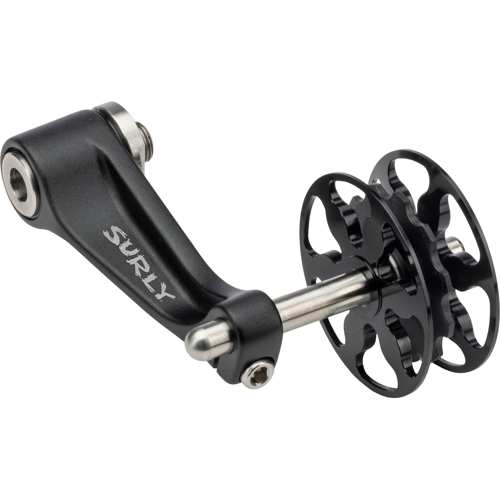

hi folks, I run a singlespeed conversion kit from the Bikemonger shop, the chain tensioner is the one in the left picture from this link ...
The problem is that it's quite noisy, it is a bit old I guess, maybe a few years can't really remember. Anyway, I'd like to replace it with something that runs a bit more silently. Has anyone got any recommendations before I make a random purchase?
I'm running a KMC singlespeed chain, I think it's the KMC Z1 EPT 3/32" - I've just looked and some of the liks have OL-2 stamped on them if it helps.

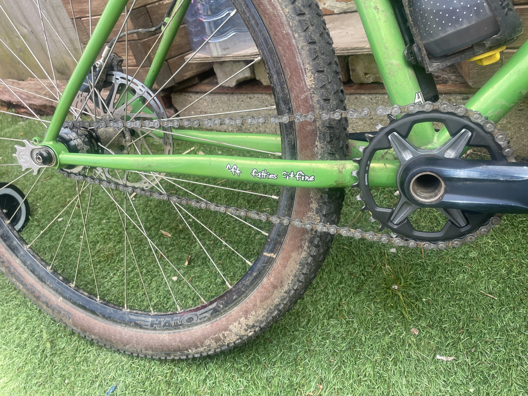

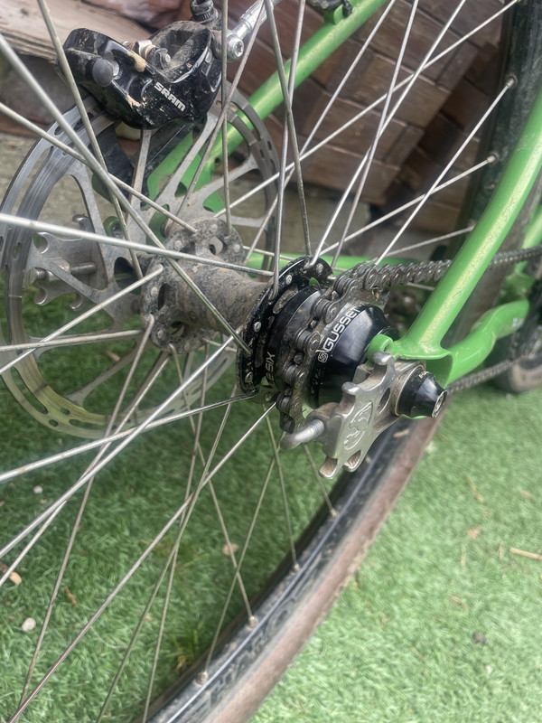

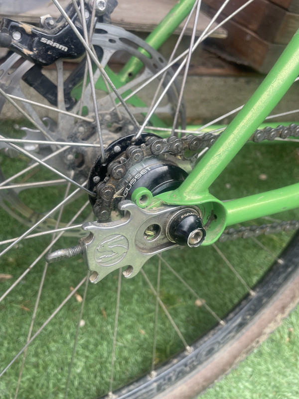

What is the dropouts / axle setup like on the bike?
also running a single speed conversion kit (gusset) same chain as you (I think) and have had very little (zero) issues / faff with Surly Tugnuts for chain tensioning

yep, it's a hardtail, old Kona frame. It's got vertical dropouts, the chain tensioner is instead of a rear mech so quite a different set up to those pics ^^ up there ^^
