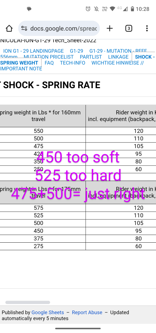

Hi,
I've recently bought a new to me G1 with a ext coil shock.
I'm off to the Dyfi bike park tomorrow and have the choice of a 450 or 525 spring.
The 525 got 50% travel in the progressiveย  175mm or a ride with some big ( for me) hits.
The 450 hit 100% travel in the 160mm less progressive setting on a ride with some tables that are as big as I can manage (3m ISH)
The Dyfi reds are fun but tough for me, the blacks are right at the top of what I can ride on a good day, the double black are not happening.
I've been trying to buy a 475 and 500 springs, but they are not arriving tomorrow.
I'm 95kg in riding kit.
Both setups above have felt great.ย
Which spring would you ride in which travel setting?
ย
Screenshot_20250722-102810~2.pngย
Posted : 31/07/2025 2:37 pm

Why have you done 60/160* shock rate to get a weight in lb? Is this a force to compress the spring in the different travel settings?
Sorry, should have been 65/160 and 65/175, but the results still directionally valid.ย
In terms of units it doesn't matter as that part of the calculation is just a ratio.ย  65/160 is the same as 2.56/6.29.ย  Shock springs are in pounds per inch. So one times the other tells you the actual suspension rate at the rear wheel.ย
My point in a roundabout way was trying to get towards the fact that if you only use half the shocks stroke (in 175mm + progressive) to get similar suspension load (to 160mm + linear) then you need a lot more damping because the shock is being asked to dissipate the same energy in a shorter distance.
Sounds like you've solved the problem by getting a compromise spring anyway.ย

Sprindex might be useful as an upgrade in future.ย
I agree. However I can't find one to fit in the 450-500 65mm stroke.. They seem out of stock everywhere I've looked.ย
ย
The 450 spring felt fine for the first lap, then my mate needed to faff with is brakes and I tried his 500 in the 175mm travel. It felt awesome 😊
@thisisnotaspoon
Thanks, that makes sense.I left the settings as they were and it felt great.ย
But of fiddling with the fork- more pressure and faster rebound and compression and the bike was calm and predictable. IMG_20250801_125605325_HDR.jpgIMG_20250801_151549972.jpgย
