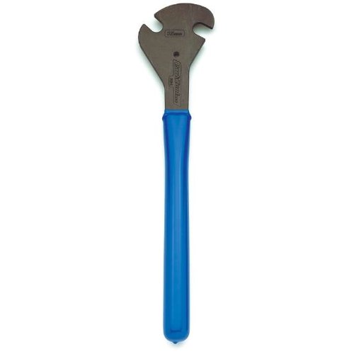

Posts: 39665
you tried a real pedal spanner ?
if you aint used one of those , your pedals are not yet declared stuck 😉

No spanner flats, so haven't tried a proper spanner, but I have spiralled an allen key using a long lever and two LBSes have said 'they are not coming off'
