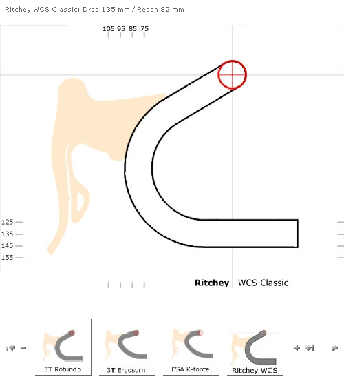

Well I can get 2 fingers on the brakes with the current bars, the Alpkit ones looked like they would need the levers in a very unnatural position to achieve the same.
jimdubleyou
Look on whatbars.com for visual comparisons
This is really good, shame it doesnt show a side profile.
Basically if you look below, the Ergosum & K-force have the levers set much further way because of the shape.
Which means according to this old thrread I probably want bar shape 1 or 4
right, but can't you just compensate for that by winding the lever reach back in, so the distance between the finger you want to use and the bbar is about the same, regardless of bar?
Posted : 12/09/2022 2:55 pm
Posts: 7959
Perhaps on some but not the Alpkit, would prefer to get bars that suit me than make levers suit bars that don't.
Posted : 12/09/2022 2:58 pm
Posts: 7192
Interesting how they’ve set up the images of profiles above.
I pretty much exclusively have my drops set up with the “cow horn” part of the bar horizontal and the hoods running off that in as straight a line as I can get. They all seem to have them angled down and a sort of v shape formed with the hoods.
Obviously affects the reach, but I quite like how I do it and the images look weird to me, but maybe I’m the weird one…

Posts: 11606
I also thought the bars are set up wierd but I dont have classic shape road bars.
I set mine up similar to 3 (and my bars are that shape) with the bullhorn level and a smooth transition into level hoods.
If you raise or lower the bullhorn part, and then compensate by moving the hoods up which you see quite often when someone attempts to raise the bar position, I think that makes it harder to reach the brake levers from the drops. I found compact style bars in shape 3 were best for reaching the brakes, and set level you tend to hold the bars higher on the drop. I've of the bars I have are Selcof I think.
Mine are the bottom bars and taking that photo make me realise I had raised the bullhorn slightly.
Finally, I don't think adjusting your lever reach is at all bodging a bad bar to fit. You said yourself you have stumpy digits, that's what lever reach is for. And everyone adjusts it on their flat bar MTB brakes where it's a feature, don't they?
