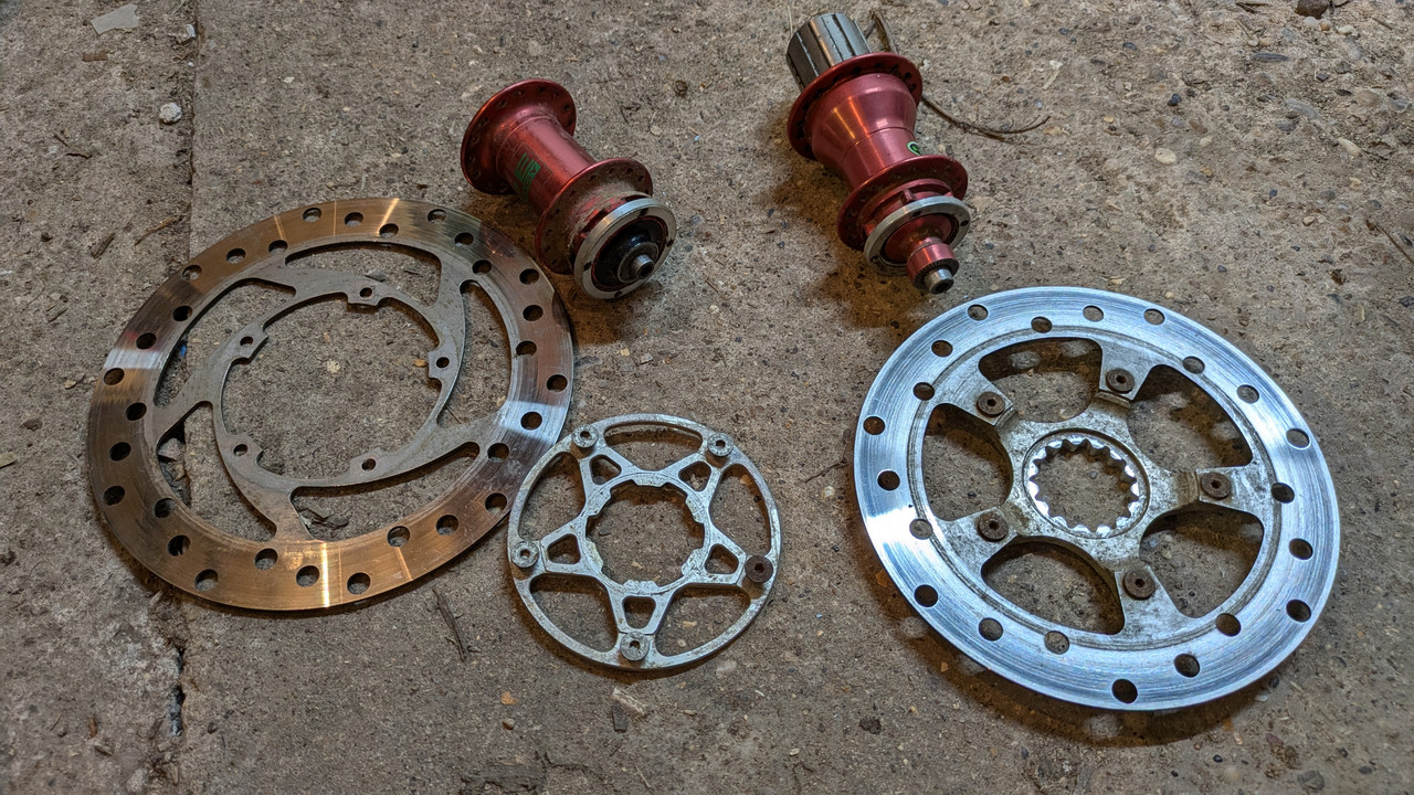

Riding the SDW on Saturday, and the rear lock ring (which WAS tight) is now loose, causing the rotor to rattle wildly... Sigh..!
Also, my rotors have always had a few mm for/aft rock.
Now, it may be that I'm using 6 bolt rotors with adaptors? Or is there always inherent rock?
I really much prefer 6bolt... More redundancy in that design (heck... Didn't people used to race with only 3 bolts?)...
I've some PROPER centrelock rotors on the way, but am I missing something? I imagine it's easier to machine a hub that way?
Are there benefits?
No, not several mm, maybe 1 or 2 on some floating rotors (between carrier and braking surface), should be no rock between centrelock splines, dunno what convertors you have, they may add some clearances.
Riding the SDW on Saturday, and the rear lock ring (which WAS tight) is now loose, causing the rotor to rattle wildly… Sigh..!
It probably wasn't tight, or you've over tightened it/cross threaded it and damaged the thread or the adaptor. Or maybe the adaptor is rubbish.
The benefit is one tool, one fixing, so it's easier to not make a mess of, easier to fit in the factory, makes the hub lighter, probably makes little difference to machining complexity (all those little teeth are fiddly to do). Also should be easier to keep it flat (as it's not dependant on 6 fixings on the same flat surface all being tightened evenly). Doesn't mean much though, all the most warped discs i've had have been centrelock...

Posts: 4628
The discs do rotate ever so slightly on the centerlock spines, but this is only an issue if you brake when the bike is rolling backwards. I've never had any other issues with them, they seem fine, but then so do 6 bolt rotors.
I've always thought the 6 bolt to centerlock adapters looks a bit flimsy, but I don't think any of the issue you describe can be attributed to them.
Benefits (to me) are that it's easier to remove/refit the discs if you travel with the bike a lot.
I'm sure there are also benefits to the manufacturer in the initial assembly process, but they don't affect me.
I've gone to centre lock on all my bikes just because it's easier to remove/refit rotors - not that I do that very often.

Posts: 10521
If your centre lock rotors are moving on the splined mount on the hubs, they're not installed correctly or either the hub or rotor is knackered. Or if you're using adapters, the interface between the disc and adapter is knackered. I'm pretty certain they're meant to be done up to 40Nm, just like cassettes, so bloody tight!

If your centre lock rotors are moving on the splined mount on the hubs, they’re not installed correctly or either the hub or rotor is knackered.
I've seen it on multiple wheels on multiple bikes, both straight from the factory and shop/self maintained. And with torques checked with a torque wrench.
Eg brand new DT factory wheels with brand new Shimano rotors. Took them off, checked everything, retorqued, still doing it. But definitely not the only one. My RS4s with brand new rotors do it as well. I've also seen it with Shimano hubs and rotors.
Maybe it's an 'opposite ends of tolerances' issue, or something else, but I'd very much disagree with your 'presented as absolute fact' statement.

If you can tighten a CL lockring to 40Nm and the spline interface still rocks, it's almost certainly faulty. The end load at 40Nm is massive, the rotor will be clamped "very firmly".
I'd suspect that it's not tightened down onto the rotor itself, the thread has bottomed out somewhere.

From an engineering point of view - centrelock is shit!
The high torque rating required over quite a narrow area/limited number of threads is asking a lot of the aluminium hub shell (and lock ring).
The splined tool interface is another crap part of it - the design was fine for steel HG cassette lockrings but not for the aluminium material of a CL lockrings.
If the thread is damaged due to the above then it's new hub time - at least a damaged 6bolt thread can be helicoil repaired.
In its favour CL is easier/quicker to assemble.
