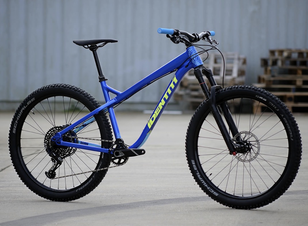

Identiti aka would be cheap and decent. A medium on ebay for not much. Get some plumbers freeze spray and blast that in the seattube from the bottle bosses mount and you can usually crack free the seatpost. You would get an ok amount for a bigwig second hand with that done.

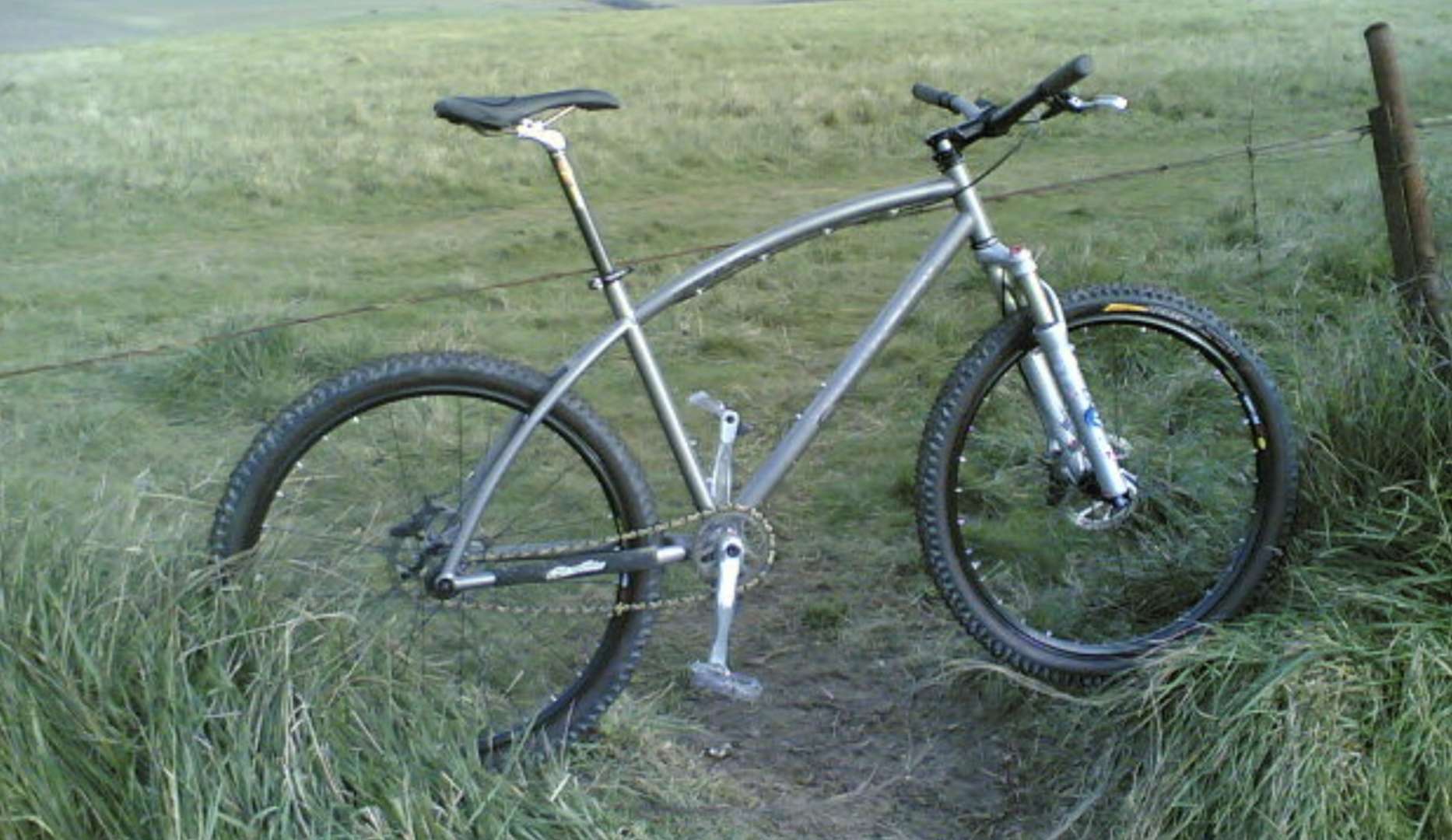

This thread got me searching for a picture of the Modro. The EBB was completely useless and took up zero slack in the chain. This was the first ride out on it. Had to buy a half link in the end. IMG_1312.jpeg

thats is the worst promo photo of a bike ive ever seen. What use is that?
🤣 ... I thought that too!

I am not a photographer but as a layman I do tend to prefer promo pictures that actually show the bike 😂
